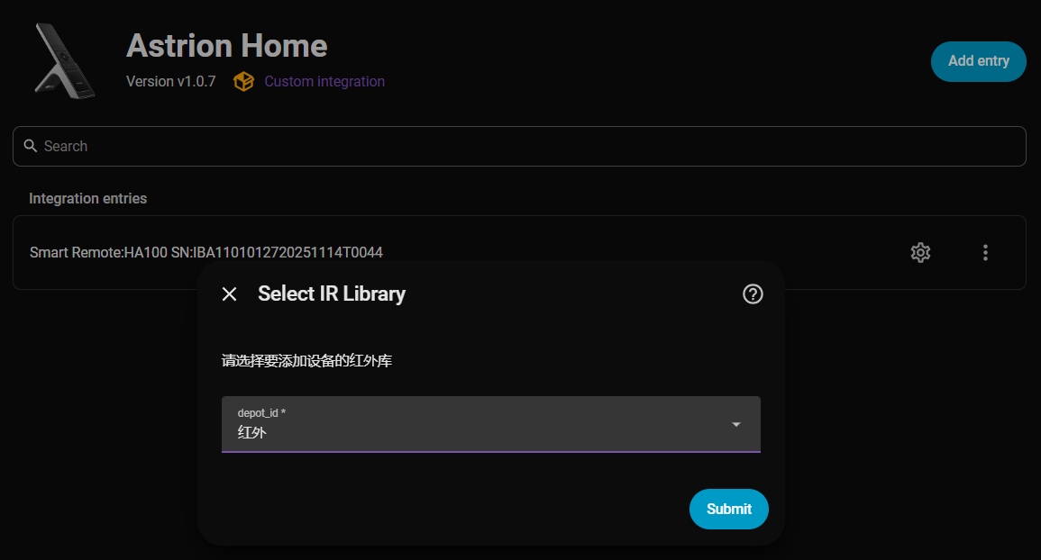

When selecting configure from the Astrion Home integration. The writing is in Chinese characters, I am not sure what it says. Needs to be translated.
it means IR, I will ask the engineer to fix this bug, thanks for the feedback

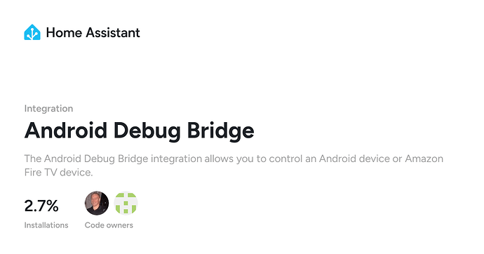

The ADB latency issue has always been present and is impacting the long press more than anything, the only way to accurately use the remote is to do one action and movement at a time and wait for the most recent button press to catchup on screen before performing the next action, otherwise you drift into the wrong menu, or activate the wrong menu item unintentionally.
As mention the ADB issue is a separate issue and not related to changes in the latest firmware. I was just stating the frustration at not beinbg able to use the remote with the ADB latency impeding the experience.
So to confirm it seems that the changes in the latest firmware is related to the error message about the harmony controller which breaks the TV card whilst using a configured remote that does not use ADB.
Apologise for any confusion, I should have mentioned the ADB latency separately.

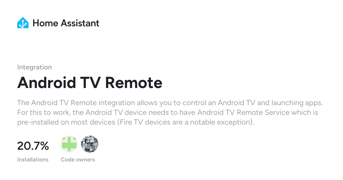

Have you tried
rather than
supposedly there is a difference.
Hi Mr. J, we apologize for the poor experience caused by the ADB latency. I have reported the issue to our R&D team, and they will investigate the possible causes of the high ADB control latency one by one.
According to the R&D team’s analysis, the ADB control latency can be categorized into three situations:
Ā·Situation ā‘  and Situation ā‘”: Similar latency times, both relatively high. Situation ā‘  uses HA-defined key values, and Situation ā‘” uses the adb shell input keyevent xx command.
Ā·Situation ā‘¢: Using the sendevent method, which is closer to the underlying layer and has lower latency.
Therefore, our engineers suggest you try the following two adjustments:
Ā·Solution 1: Paste the Android bridge command into the remote control, or create a script and bind it to the button.
Ā·Solution 2: Use developer tools to learn the ADB keycode values ​​of the Android TV, then paste the learned keycode values ​​into the TV card, or set it as a script and bind it to the button. (I can provide a learning document if needed.)
Furthermore, our R&D team would like to know if you can provide more details: When using the Android bridge to achieve latency-free control, are you binding it via entities or scripts? We would also appreciate it if you could provide the relevant control code values ​​so we can further analyze the specific causes of the latency.

Android TV Remote is currently broken with ā€œFailed to fetch harmony configā€ error.
