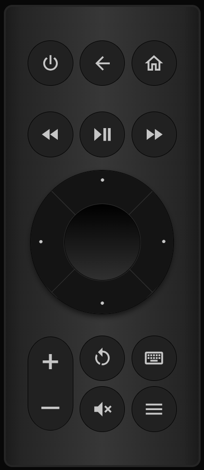

Below is an example yaml showing what HA entities are used for mapping my keys on my dashboard remote GitHub - PRProd/HA-Firemote: Apple TV, Amazon Fire TV, Chromecast, Homatics, NVIDIA Shield, onn., Roku, Xiaomi Mi, and Android TV remote control card for Home Assistant
  - type: custom:firemote-card
    entity: media_player.shield_debug_bridge
    device_family: nvidia-shield
    device_type: shield-tv-pro-2019
    compatibility_mode: default
    android_tv_remote_entity: ""
    defaultRemoteStyle_override: AL2
    app_launcher_relative_size: -30
    button_overrides:
      mute-button:
        service: switch.toggle
        target:
          entity_id: switch.nad_mute_switch
      power-button:
        service: remote.toggle
        target:
          entity_id: remote.harmony_hub
      left-button:
        service: button.press
        target:
          entity_id: button.harmony_left
      right-button:
        target:
          entity_id: button.harmony_right
      up-button:
        target:
          entity_id: button.harmony_up
      down-button:
        target:
          entity_id: button.harmony_down
      center-button:
        target:
          entity_id: button.harmony_select
      volume-down-button:
        target:
          entity_id: button.harmony_volumedown
      volume-up-button:
        target:
          entity_id: button.harmony_volumeup
      reboot-button:
        target:
          entity_id: button.harmony_surroundmode
    scale: "100"
    hide_button_group_frame: true
    dpad_style: apple-tv-black
    useCustomSkin: false
    skin: "#7246b4"
So what I need is to be able to have my TV Roscard below have the above entities inserted.

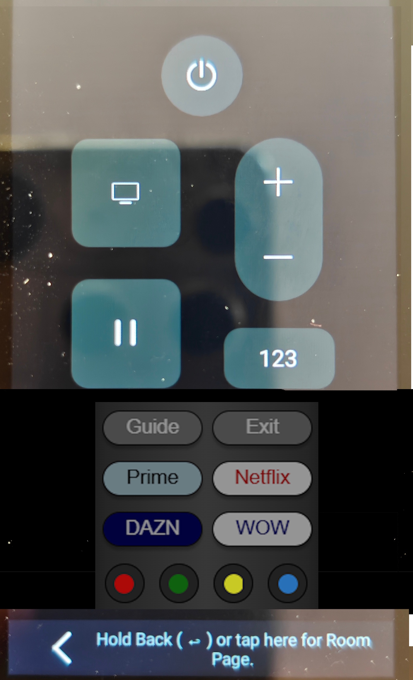

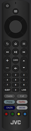

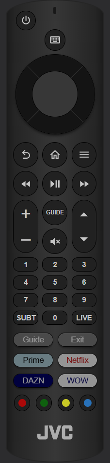

Hi,
I’d like to share my Firemote config here as well. As you can see basically every button is scripted. This allows me to implement the complete TV logic into HA. As mentioned before I also combined multiple devices into 1 logical remote. The remote knows which device is selected and how the buttons need work in each scenario.
entity: media_player.fire_tv_cube
device_family: amazon-fire
device_type: fire_tv_cube_third_gen
defaultRemoteStyle_override: AFJTV
visible_name_text: IPTV
name_position: hidden
grid_options:
  rows: 13.79
  columns: 12
app_launch_1: customlauncher My_EPG
app_launch_2: customlauncher My_Exit
app_launch_3: customlauncher My_Prime
app_launch_4: customlauncher My_Netflix
app_launch_5: customlauncher My_DAZN
app_launch_6: customlauncher My_WOW
scale: "85"
button_overrides:
  num1-button:
    script: tv_channel_select
    data:
      channel: NUM1
  num2-button:
    data:
      channel: NUM2
  num3-button:
    data:
      channel: NUM3
  num4-button:
    data:
      channel: NUM4
  num5-button:
    data:
      channel: NUM5
  num6-button:
    data:
      channel: NUM6
  num7-button:
    data:
      channel: NUM7
  num8-button:
    data:
      channel: NUM8
  num9-button:

custom_launchers:
  - friendly_name: My_Exit
    label: Exit
    color: white
    background: grey
    script: tv_send_key
    data:
      key: EXIT
      keyevent: "3"
  - friendly_name: My_Prime
    label: Prime
    color: black
    background: lightblue
    script: fire_tv_prime_video
  - friendly_name: My_Netflix
    label: Netflix
    color: red
    background: white
    script: fire_tv_netflix
  - friendly_name: My_WOW
    label: WOW
    color: darkblue
    background: white
    script: fire_tv_wow
  - friendly_name: My_DAZN
    label: DAZN
    color: white
    background: darkblue
    script: fire_tv_dazn
  - friendly_name: My_EPG
    label: Guide
    color: white
    background: grey
    script: tv_send_key
    data:
      key: EPG
      keyevent: ""

Hi Charles,
Version 1.1.1 of the software is a major step forward into the right direction, especially adding support for scripts in the TV card. Thanks to you and your team for this and thank you for taking community feedback serious. This is not a given.
To make the TV card even more useful I would like to suggest to add several (more ist better) optional, configurable, scriptable buttons to it. I’ve cobbled together a picture to illustrate what I mean:
This would also be useful for the Media Player card. For example to configure radio presets etc.
Hi @starob,
Thank you very much for the kind words and for recognizing the progress in version 1.1.1. The team really appreciates the community’s feedback, and suggestions like yours are exactly what help us move the product in the right direction. :+1:
Your proposal to add optional configurable buttons to the TV RosCard is a very good idea, and we have already discussed something similar internally. Based on feedback from users like you, we will consider adding customizable buttons in future versions.
Our current direction is roughly as follows:
  • App Launcher Buttons – similar to the concept used in the Fire Remote example (quick access to apps such as Netflix, YouTube, etc.).
  • Custom Script Buttons – users will be able to bind these buttons directly to Home Assistant scripts or services, making it easier to trigger automations or custom device actions.
  • Editable Button Labels – users will be able to modify the text name shown on the icon/button, so it can match their own setup (apps, presets, scenes, radio stations, etc.).
This concept would also apply nicely to the Media Player RosCard, as you mentioned (for example radio presets, favorite inputs, or commonly used actions).
Your mockup is very helpful for visualizing the idea, and I’ve forwarded it to our development team so it can be considered during future UI iterations.
Thanks again for contributing to the community and helping us improve Astrion. Please keep the ideas coming — they are genuinely valuable to us. :rocket:
