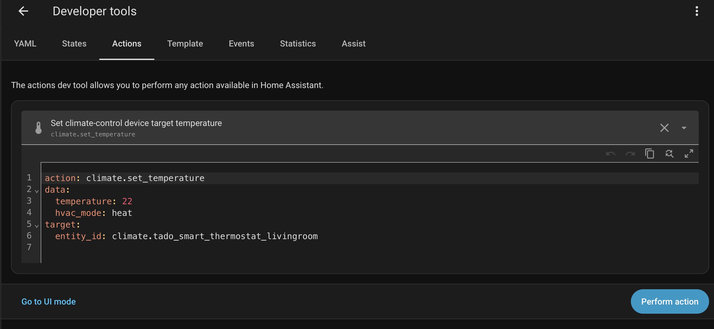

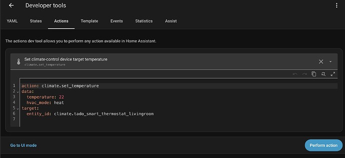

:white_check_mark: 2. Service Call Test
Please test this in Developer Tools → Services:
Service:
climate.set_temperature
Target:
climate.your_entity
Data:
temperature: 24
:backhand_index_pointing_right: If this works, then the issue is likely RosCard mapping, not the device.

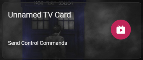

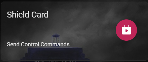

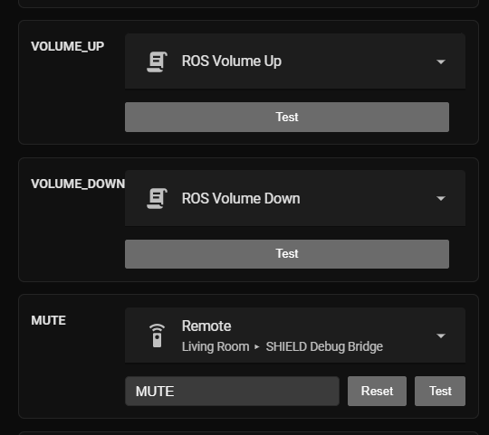

TV ROS Card not showing on the remote? I just tried adding scripts for volume and on refreshing the remote (also power cycling) the card no longer shows on the remote.
Also tried setting up a fresh TV ROS Card, not displaying on the remote.

:warning: About Using Scripts for Volume
Since you mentioned adding scripts for volume:
  • Make sure:
    • type: script is correctly set
    • entity_id points to a valid script
  • Avoid leaving value empty when using script bindings
Misconfigured keys can sometimes prevent the card from rendering.

:test_tube: Quick Test
Please try in Developer Tools → Services:
service: climate.set_temperature
target:
  entity_id: climate.tado_smart_thermostat_su3880471808
data:
  temperature: 24
:backhand_index_pointing_right: If this works:
  • Then the issue is card compatibility, not the device

Minimal YAML not working
type: custom:aiks-tv-card
uuid: 2b144720-0854-4230-9a53-4dcce9016678
tv_type: android_tv
tv_name: Unnamed TV
media_play_entity: media_player.shield_debug_bridge
entities:
  - key: POWER
    type: remote
    entity_id: remote.shield_debug_bridge_remote
    value: POWER

ORIGINAL CARD that does not update on the remote.
Testing the volume controls from the edit page works
uuid: de5f1989-801c-4e33-aaf7-25ef71c7e864

I have tried deleting and re-adding the cards, still not updating.
I have been able to add a new Switch Card after refreshing but the TV Card will not refresh onto the remote.
I suggest using a script to handle the elements you cannot directly control, as relying solely on key values ​​may not guarantee fully effective control.
The card was functioning perfectly fine prior trying to refresh and add scripts for the volume buttons. When testing in home assistant the scripts are working with the test button. Something is wrong or changed in the version I think for the TV card being the only card not updating.

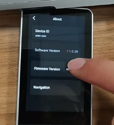

Updated software version on remote and everything is working as expected again.
I am now on V1.1.2.1

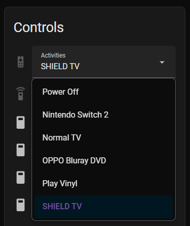

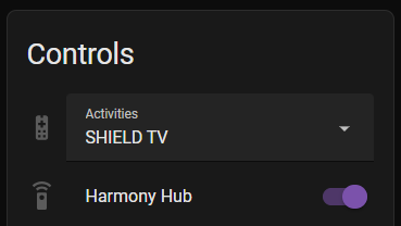

Using a script to toggle an activity on Logitech Harmony Hub is NOT ideal. I have created a switch that turns one particular Harmony Activity (Shield TV) on and off.
When I use the switch through the remote I get a constant power cycling between on and off states.
The switch works perfectly fine for voice assistants.
You need to either:
  1. Add ON and OFF Commands to the TV ROS Card, so a particular state can be selected directly from the switch.
  2. Add support to be able to select buttons and switches natively from the TV ROS Card.
  3. Add the ability to select from a dropdown list natively from the TV ROS Card
  4. Add the ability to toggle Harmony Hub entity on and off natively

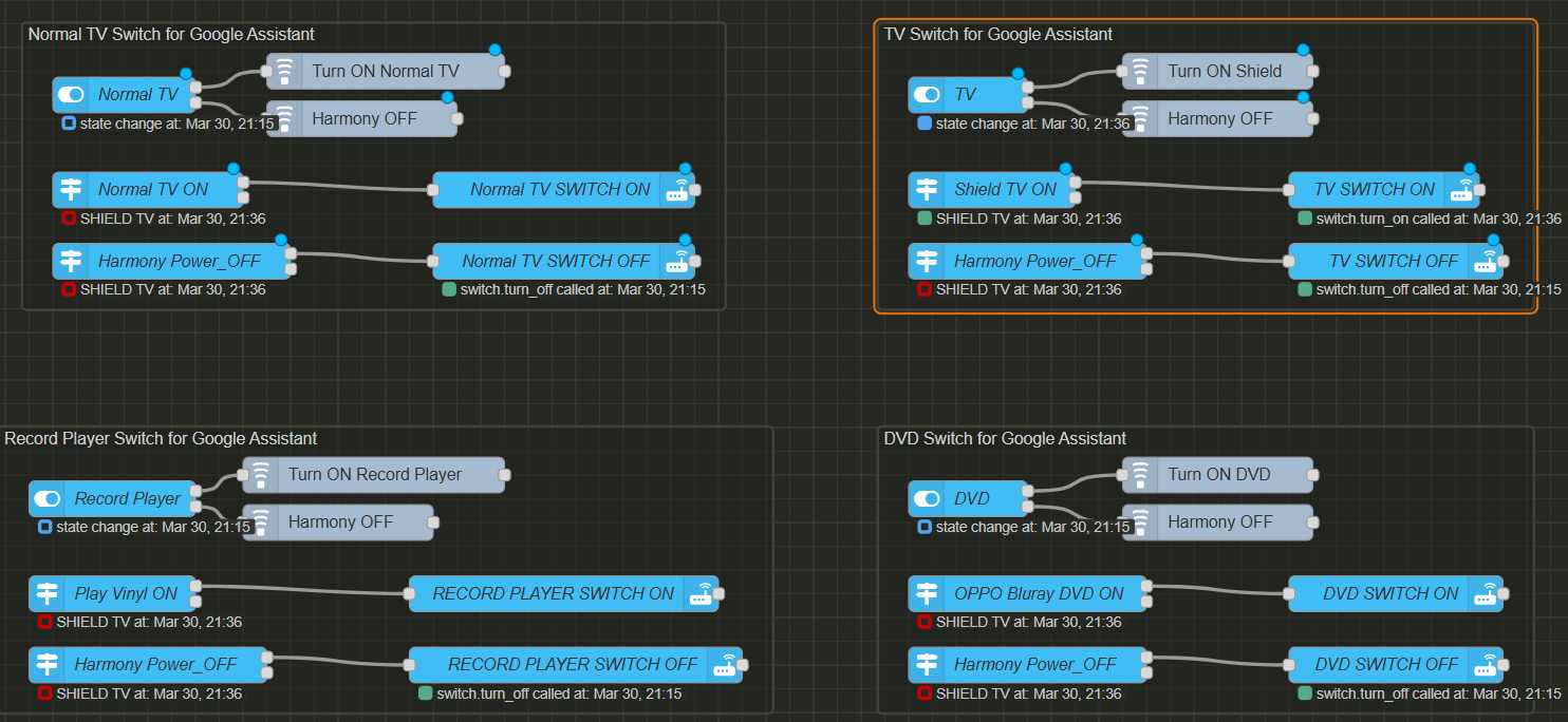

This is my NodeRED flow for the switch, that works perfectly fine for voice assistants.
I am having exactly the same issue when trying to use a Tado thermostat - the thermostat displays temperature fine, but the + and - buttons do not respond.
I’m using a Tado Smart Thermostat integrated into Home Assistant via HomeKit Controller.
What works
  • The thermostat appears correctly in Home Assistant as:
climate.tado_smart_thermostat_livingroom
  • The standard HA thermostat card (browser and iPhone app) works as expected:
    • Temperature can be increased/decreased
    • Changes are applied immediately
  • Manually calling the service in Developer Tools also works:
action: climate.set_temperature
target:
  entity_id: climate.tado_smart_thermostat_livingroom
data:
  temperature: 21
  • → This successfully updates the thermostat
What doesn’t work
  • In RosCard, using the Climate Control card:
    • Current temperature displays correctly
    • Pressing + or - does nothing
    • No visible error, just no action
Conclusion
  • The climate entity is functioning correctly in Home Assistant
  • climate.set_temperature works as expected
  • The issue appears to be specific to RosCard Climate Control not sending or handling the temperature adjustment correctly for this entity (HomeKit-based Tado)

I find with my Tado A/C V3 the RosCard Climate Control works perfectly. Strangely when trying to adjust the temperature via HA thermostat card I find I actually have to open the card as a pop-up to make any adjustments.
Could you please test the affected commands using Home Assistant → Developer Tools → Services (call service) and check the raw entity response?
Apologies, I’m not sure how to give what you’re asking.
I don’t see any way to view a raw entity response, as this doesn’t appear to give one. If I send the following the TRV adjusts as instructed.
