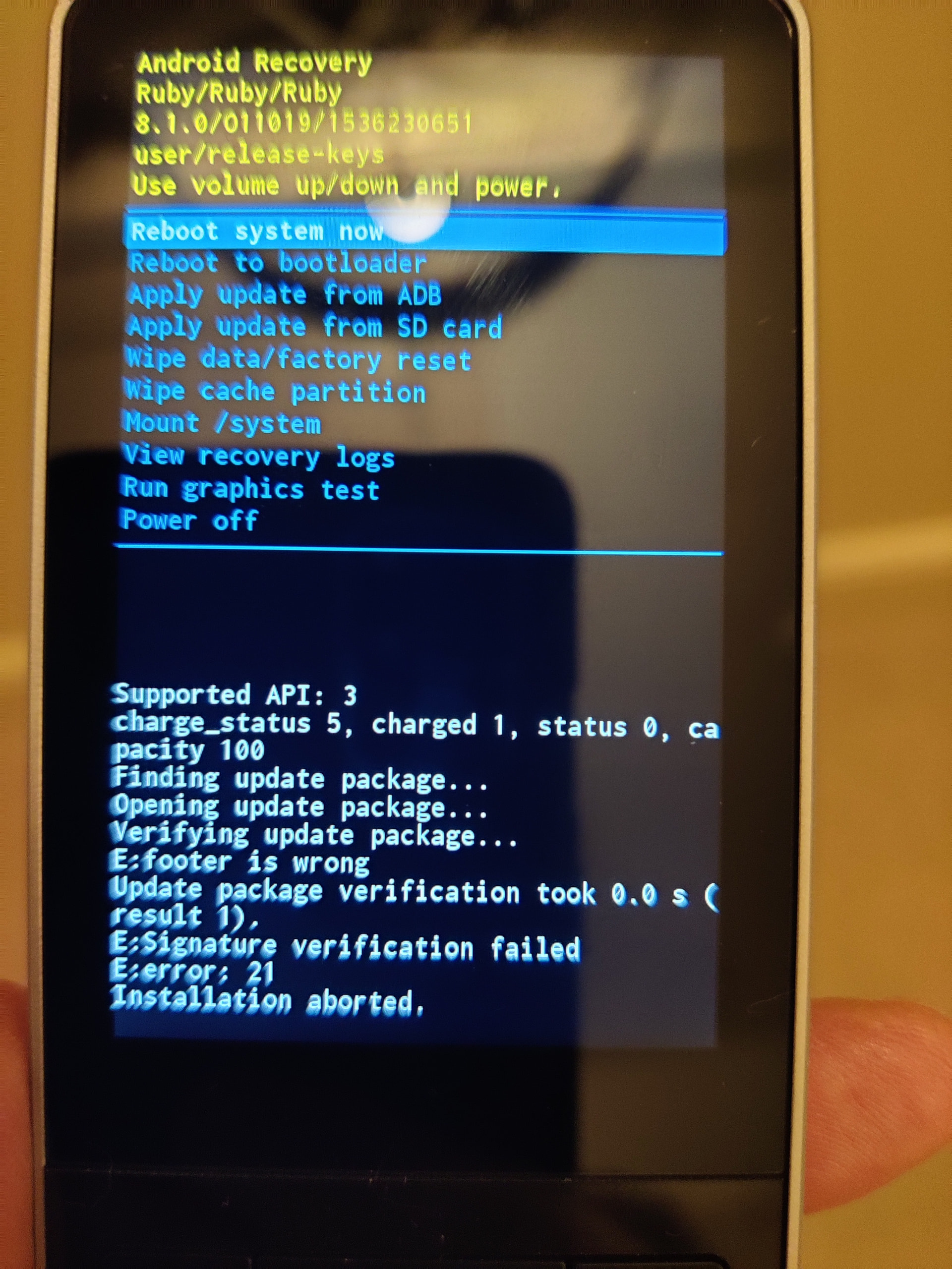

Yes - still the same after restart. The software update to 1.1.1 worked fine, and I get the notification for the new version and get the update page, but pressing update doesn’t do anything. I wonder if it’s a CDN problem. Is the server for the software update the same as that for the firmware update?
Now its working, pelase check.
Hi Charles. OK - one step forwards, but 2 back. The firmware process did begin now, and seemed to run normally until about 70%, then ran quickly to 100% but when it rebooted I got the following
Rebooting took it back to the old firmware and booted ok. I tried a second time and got the same thing, so I guess the firmware’s corrupt.
We apologize, but the verification method has been enhanced after adding the TLS certificate to the download link. We have re-uploaded the firmware, and you can try updating again now.
