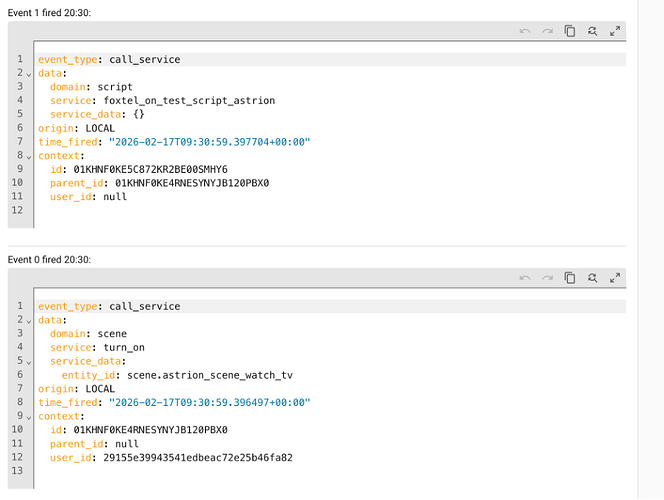

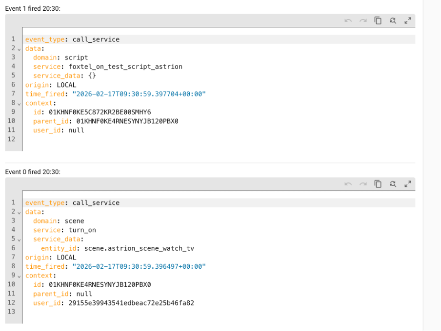

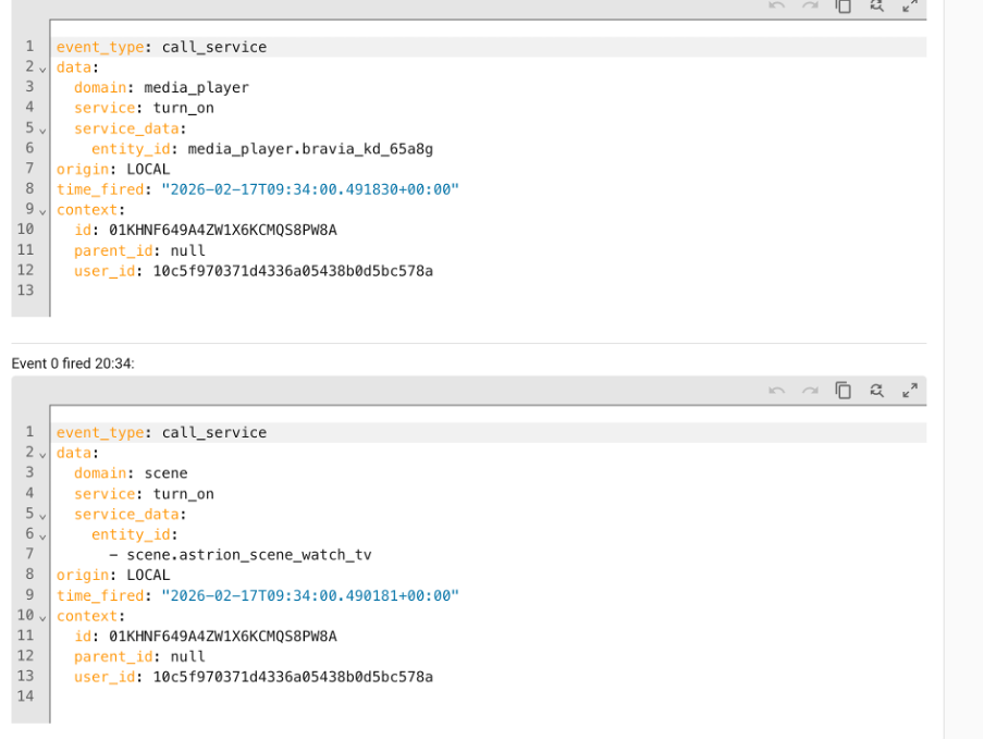

In the listner logs the format for entity id as seen in Event 0 is different when comparing the one launched manually by HA and the other via the Astrion. One has a hypen and one does not. Iโ€™m not sure if that makes a difference as my understadning the syntax is still correct.
Working Launched from HA
Not Working when using Astrion

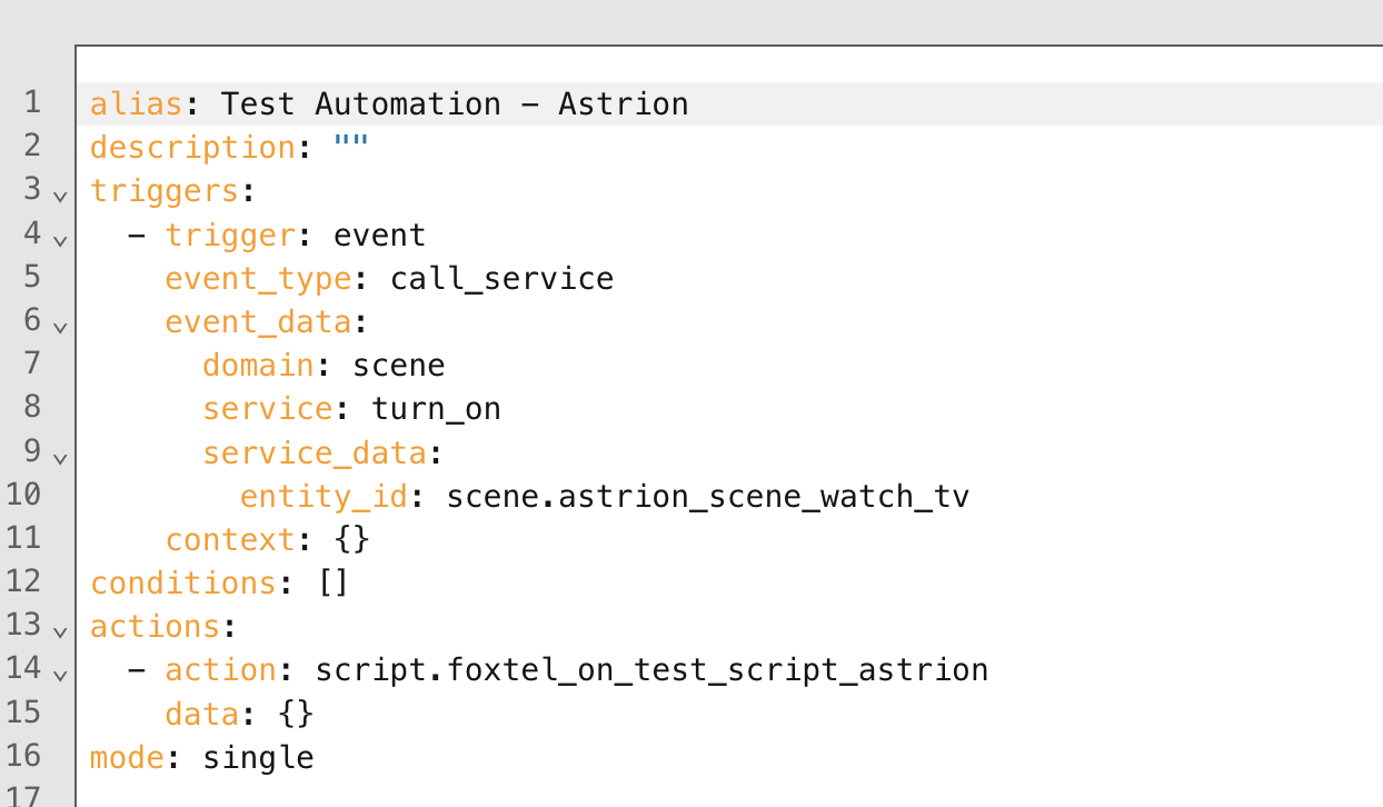

Automation
Iโ€™m at a loss why it does not work. In my opinion i thought the only thing the Astrion does is launch the Scene and HA should do the rest. Makes no sense to me why when launching the Scene in HA works but not from the remote.

The issue is almost certainly caused by event trigger filtering mismatch in your automation.
Your automation is listening for:
event_type: call_service
But when Astrion calls a scene, the service call metadata is slightly different from when HA UI calls it.
Even if both trigger the same scene, HA treats them as different call contexts.
Why This Happens
Home Assistant automations triggered by:
platform: event
are extremely sensitive to:
  • domain
  • service
  • entity_id format
  • context
  • caller source
Astrion sends a valid service call โ€” but not identical metadata to the UI call.
So your automation never matches the trigger condition.

:brain: Why Your Hyphen Observation Matters
You noticed entity IDs appearing slightly different. Thatโ€™s a good catch.
However, thatโ€™s usually just:
  • frontend formatting
  • logging representation
  • or JSON serialization differences
It rarely breaks service execution โ€” but it can break automations that match strings exactly.
So your instinct was correct :+1:
