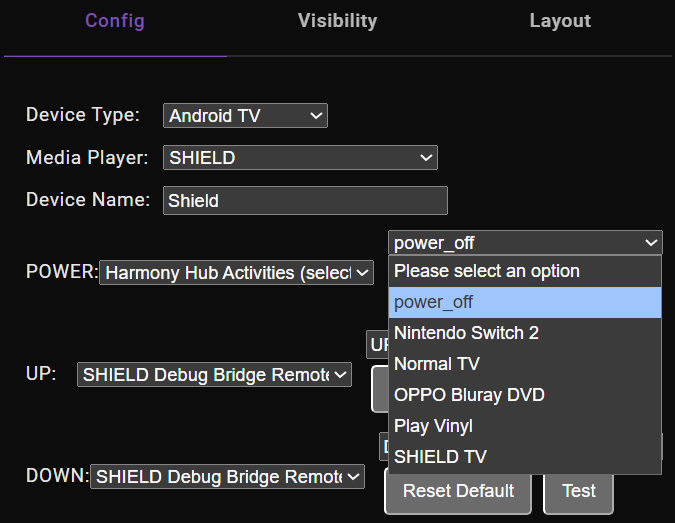

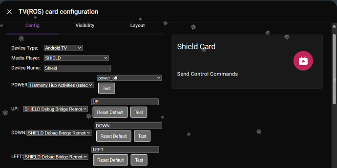

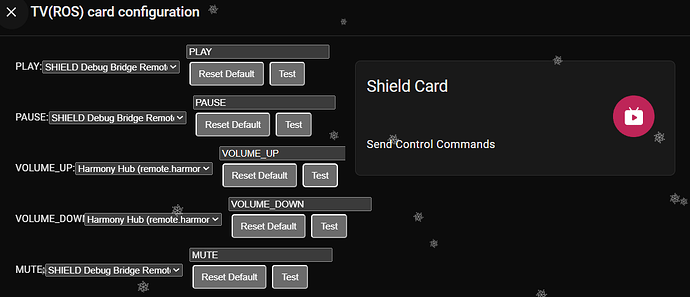

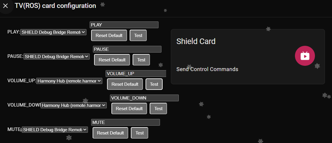

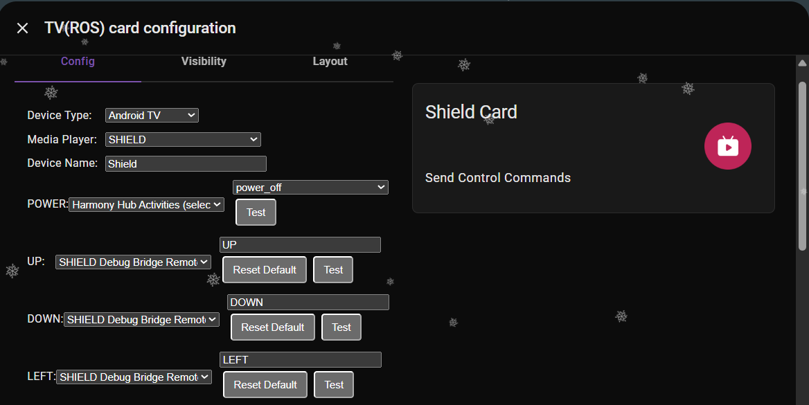

As seen below, I have managed to select my harmony as the volume control. But it does not work for volume control.
Need to be able to add a button.* entity for that command, within the TV card.
The Harmony power off activity can be mapped directly to a button. In my case below power_off works with the power button but only provides power off not toggling.
Hi @Chykan_Hunter, thanks for the detailed screenshots.
What you’re seeing is expected with the current implementation.
Although Harmony activities can be selected as a volume source, Harmony does not expose volume as a standard Home Assistant media_player volume entity (volume_up / volume_down / volume_set).
The RosCard TV card volume control currently relies on standard HA media_player volume services, which Harmony does not fully support. As a result, volume commands bound this way won’t take effect.
:backhand_index_pointing_right: At the moment:
  • Harmony power-off activities can be mapped and work
  • Harmony volume via TV card is not supported yet
We’re evaluating adding per-button command entities to the TV card in future updates to better support Harmony-style command-based control.
On Power button only does power off (no toggle)
Good observation :+1:
This behavior is normal and comes from the Harmony integration itself.
Harmony activities usually expose power_off only, not a true on/off toggle state.
Because Home Assistant cannot reliably know whether the activity is currently on or off, Astrion:
  • Sends power_off only
  • Does not fake or assume a toggle state
If an integration exposes a true toggle service, Astrion will support it automatically.
For Harmony it is an input_select list. Selecting any other option is ON and power_off is OFF.
Thanks for the clarification and screenshot :+1:
You’re correct.
In Home Assistant, the Harmony integration exposes activities as an input_select:
  • Any selected activity = ON
  • Selecting power_off = OFF
This also explains why Harmony does not provide a true toggle or volume-capable media_player entity. From HA’s perspective, Harmony is command-driven, not state-driven, which is why many advanced setups (including FireRemote) rely on explicit button entities or scripts.
This behavior is fully understood on our side.

Regarding the posted TV RosCard YAML
Your current YAML example clearly shows the limitation:
entities:
  - key: UP
    type: remote
    entity_id: remote.shield_debug_bridge_remote
The redesign goal is to remove the need to hard-code this per card, and instead:
  • Let the card define a control context
  • Let users override button behavior without duplicating entire card definitions
This will make advanced Harmony + Shield + AVR setups much cleaner.

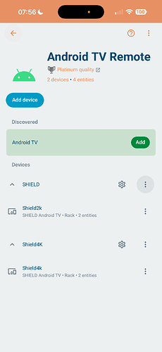

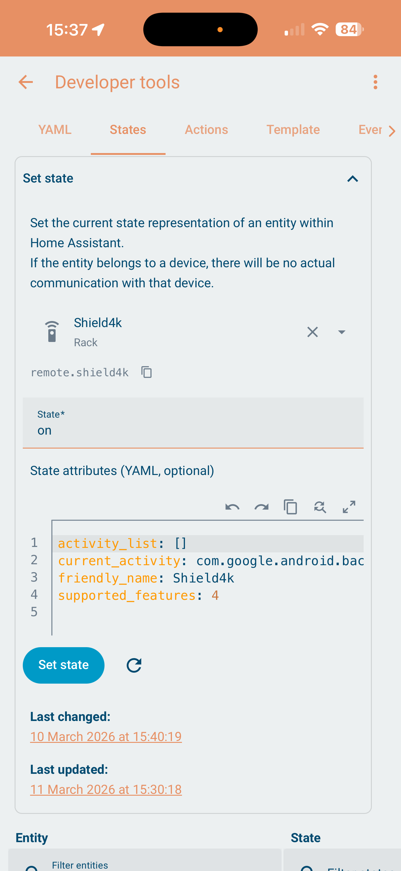

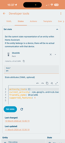

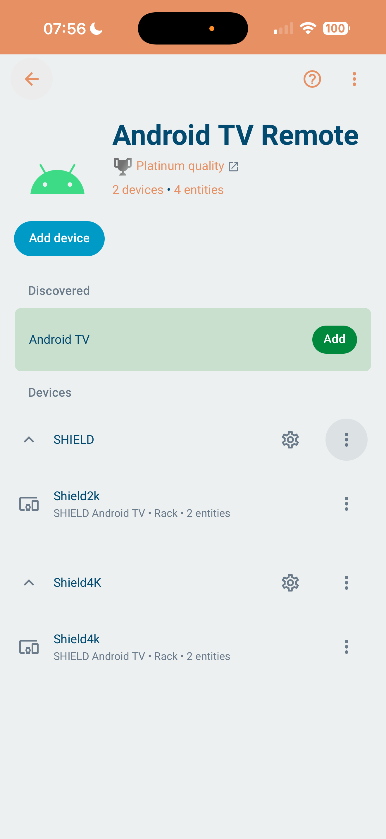

What Android intergration is everyone using im trying to use the android TV Remote and it doesn’t work claude Ai is telling me that it has to be sent like.
androidtv.adb_command with input keyevent <keycode> DPAD_UP
but my roscard sends: value: DPAD_UP
Hi @Skeltonmfc,
Good question — this can be a bit confusing because different Android TV integrations in Home Assistant use different command formats.
Short answer
If you are using the Android TV Remote integration, the RosCard command like:
value: DPAD_UP
should normally work, because the integration already understands those key names.
The command format suggested by Claude:
input keyevent DPAD_UP
is typically used for the ADB / Android TV integration, which works differently and requires sending raw ADB commands.
What to check
First, confirm which integration your device is using in Home Assistant:
Settings → Devices & Services → Integrations
You will usually see one of these:
  • Android TV Remote (recommended for newer Android TV / Google TV devices)
  • Android TV / ADB
If you are using Android TV Remote
Then the RosCard value should usually be one of the standard keys like:
DPAD_UP
DPAD_DOWN
DPAD_LEFT
DPAD_RIGHT
DPAD_CENTER
HOME
BACK
No adb_command is required in that case.
If you are using the ADB integration
Then Claude’s suggestion is closer to correct, because the command must be sent as an ADB key event, for example:
input keyevent 19   (DPAD_UP)
In that case the action would normally be sent via a script or service call rather than directly as a simple RosCard value.
Recommendation
If possible, I recommend using the Android TV Remote integration, since it works more naturally with RosCards and avoids the need for raw ADB commands.

Hi please see attached screenshot
Hi @Skeltonmfc,
Thanks for the screenshot — that helps a lot :+1:
From what you shared, it looks like you are using the Android TV Remote integration, which is the correct and recommended integration for controlling NVIDIA Shield devices with Home Assistant.
Command format with Android TV Remote
With this integration, you do not need to use ADB commands like:
Those commands are typically used with the older Android TV / ADB integration.
For the Android TV Remote integration, RosCard should normally work with the standard key values such as:
DPAD_UP
DPAD_DOWN
DPAD_LEFT
DPAD_RIGHT
DPAD_CENTER
HOME
BACK
So the value you mentioned earlier:
value: DPAD_UP
is actually the correct format for this integration.

The most important part is which entity you bind in the RosCard.
For Android TV Remote, the commands usually work best when bound to the remote entity, not the media_player entity.
So in RosCard, try selecting something like:
remote.shield4k
instead of:
media_player.shield4k

If possible, please also share which entity you selected in the RosCard configuration (media_player vs remote), and we can help narrow it down further.
Thanks again for sharing the screenshot — Android TV / Shield setups are very common, so getting this configuration right will definitely help other users too. :+1:
Hi I selected remote.shield4k, I tried it thorough developer tools still no luck I also have an older shield but that doesn’t work either. What I have noticed is that on the Nivdia Shield app the application launch works but the DPAD doesn’t. I’ve tried rebooting, clearing cache etc still no luck it’s very strange
Hi @Skeltonmfc,
Thanks for the update and for testing it through Developer Tools — that’s actually a very useful clue.
Since application launching works but the DPAD commands do not, it suggests that the connection between Home Assistant and the Shield is active, but the command format expected by the device may be slightly different.
A few things we can try to narrow this down:
:one: Test the command format in Developer Tools
Instead of sending just:
DPAD_UP
try sending it as a list format, which some Android TV devices expect:
Service:
remote.send_command
Target:
remote.shield4k
Command:
["DPAD_UP"]
Some integrations require the command to be passed as an array rather than a plain string.
:two: Test a few other navigation commands
Sometimes specific buttons behave differently depending on the active app.
Try these as well:
DPAD_CENTER
BACK
HOME
If those work but the directional keys don’t, it could be related to the current app focus.
:three: Confirm the entity supports directional commands
In Developer Tools → States, open:
remote.shield4k
and check the supported_features field.
If the remote entity was created through the Android TV Remote integration, directional commands should normally be supported.
:four: Try using the media player entity as a test
Even though the remote entity is usually recommended, some Shield setups respond through the media player service instead.
Example test:
Service:
media_player.play_media
Target:
:five: Quick sanity check
Since you mentioned that:
• the NVIDIA Shield mobile app works
• application launching from HA works
• both your Shields behave the same
this makes me suspect it may simply be a command formatting issue rather than a connection problem.
If you don’t mind, could you also share:
• the exact command payload you tested in Developer Tools
• a screenshot of the remote.shield4k entity attributes
That should help us pinpoint the behavior quickly.
