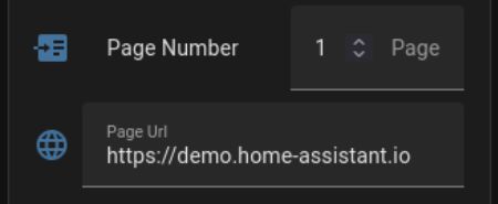

Touchkio has implemented this by exposing MQTT sensors.
  • Page Number - A JSON list of URL’s held within the kiosk
    • Possibly a list that could be navigated to in the Astrion settings
  • Page URL - Direct URL to the page
    • With the Astrion it would have to expose the view and card i.e.
    • To a TV Card - /Media/TV_Card
    • To a particular light - /Lights/Light_Control_Card/Curved_Floor_Lamp
    • To a page that contains all lights - /Lights

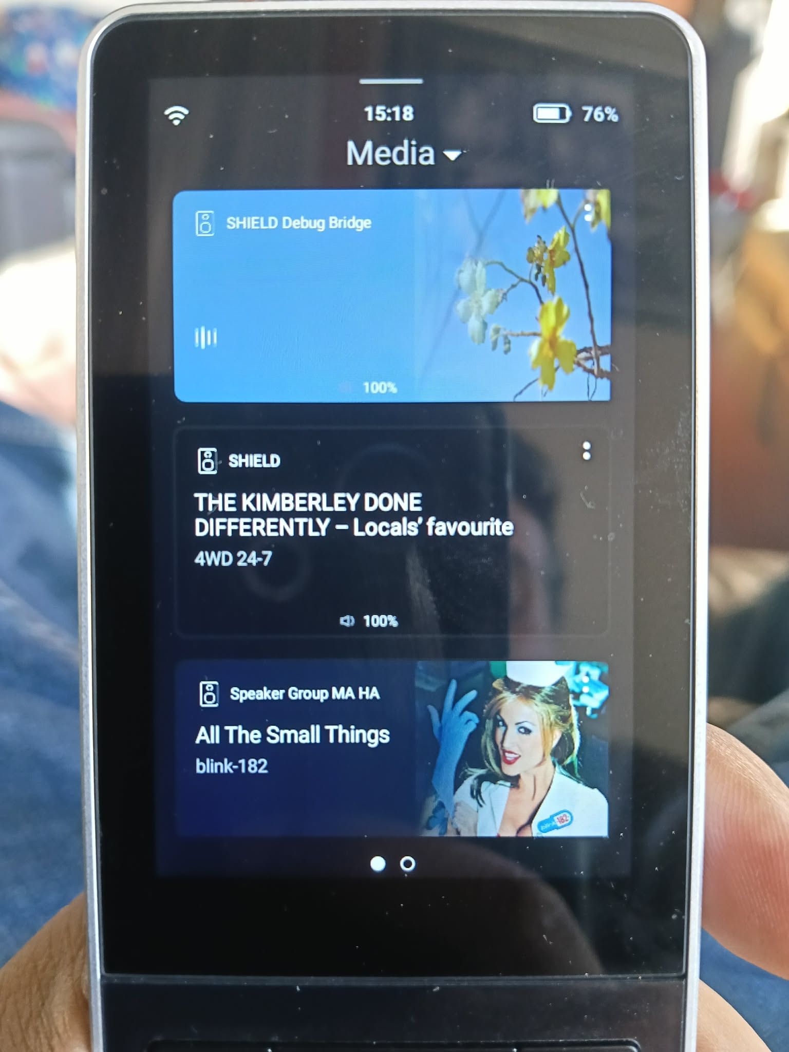

So I’ve done a lot more work and now have a new custom media entity in HA that updates faster and passes through media controls, fixes a lot of issues with the previous method but the restrictions of ROScard are still a barrier to better integration.
the card on the remote can show Artist and Album, but it cant show an app name or a movie title as far as I can tell, I am using some node-red funny business to translate these into Artist and Album fields as well as replacing NULL values with “ “ empty strings so that when switching the media_entity data source on the fly it doesn’t get stuck displaying the previous data if the new entity didnt have those fields for example. that is all a massive hack but with the current way the remote works it is my best option.
The card is rendered in an awkward layout, the play queue button is overlayed on the artwork but the input select (using the radio icon) is drawn next to the previous track button but offset awkwardly like its position is an error.
this layout could be greatly improved, especially if it were configurable from ROScard, even it it a choice of a few set layouts, or some ability to send a media type flag on the Media_entity to display the data in a different layout or with different data fields.

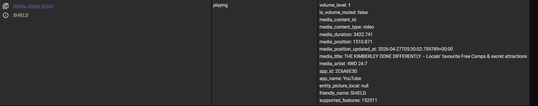

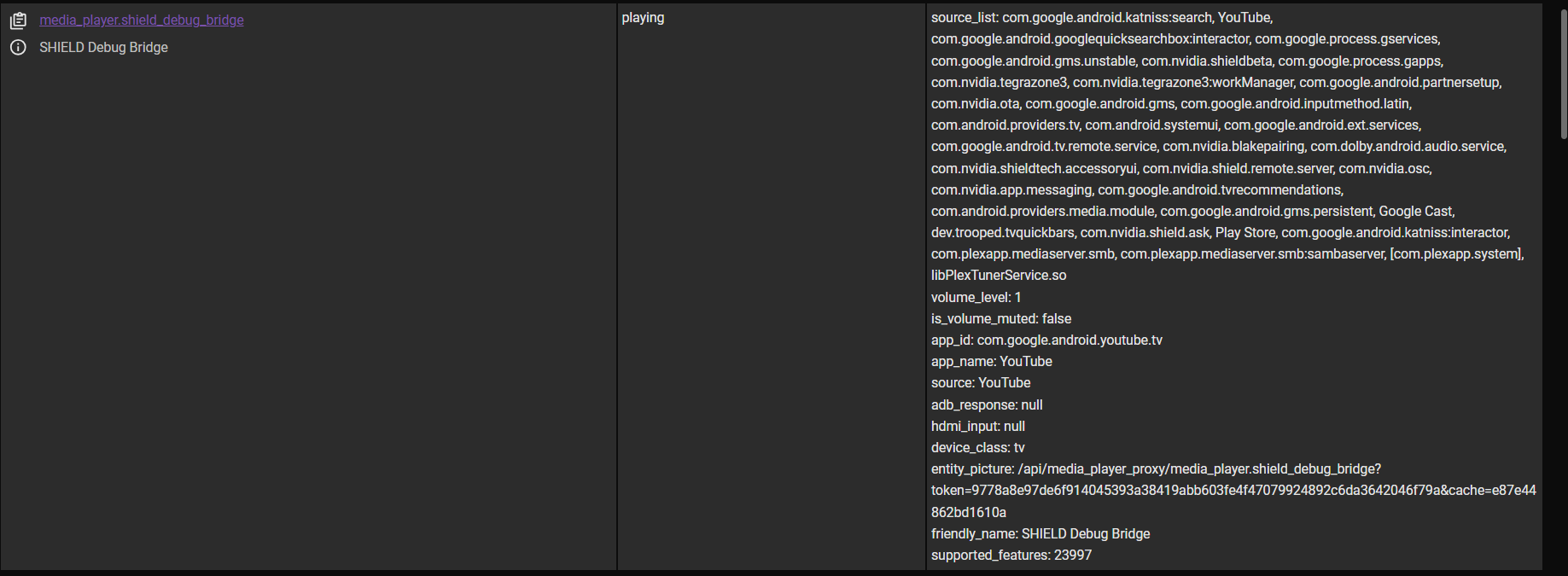

I have integrated my Shield TV with the chrome cast entity and android debug bridge entity.
When using both with Youtube, I have noticed a difference with different apps.
Android Debug Bridge
  • Provides screenshot
  • No media position function
  • No titles
Chromecast
  • No screenshot
  • Media position shows
  • media_title: shows
  • media_artist: shows
I’m pulling that data into a function node in Nodered and translating/sanitising the values to make a custom master media entity for the Astrion, it’s taken a bit of faffing about and I had to resort to asking gemini which I’m not proud of, but it grabs the current media player device config, replaces missing values with empty strings so you dont get ghost data stuck on screen (astrion ignores NULL data and keeps showing the old text) it also does things like moves the “app_name:” into the “artist” field and puts my current source in the track field for example.

Looking at the different Apps on the Shield, it will only give me media title, artist and position for Youtube. Disney, prime etc. do not show media title or position. Not really worth the effort for a card I do not use anyway.
