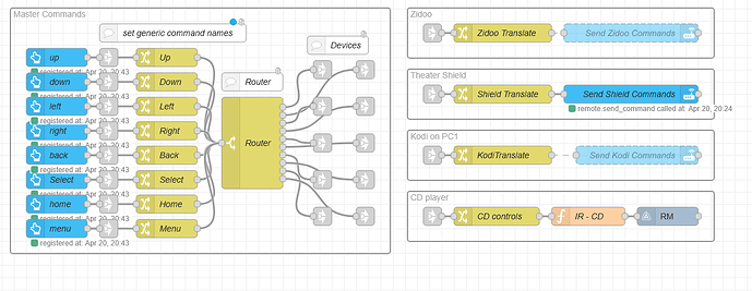

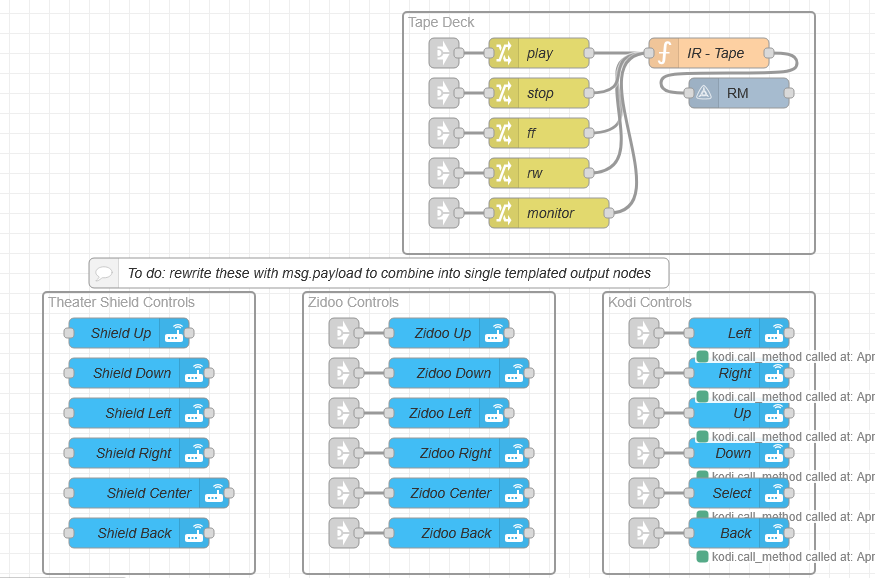

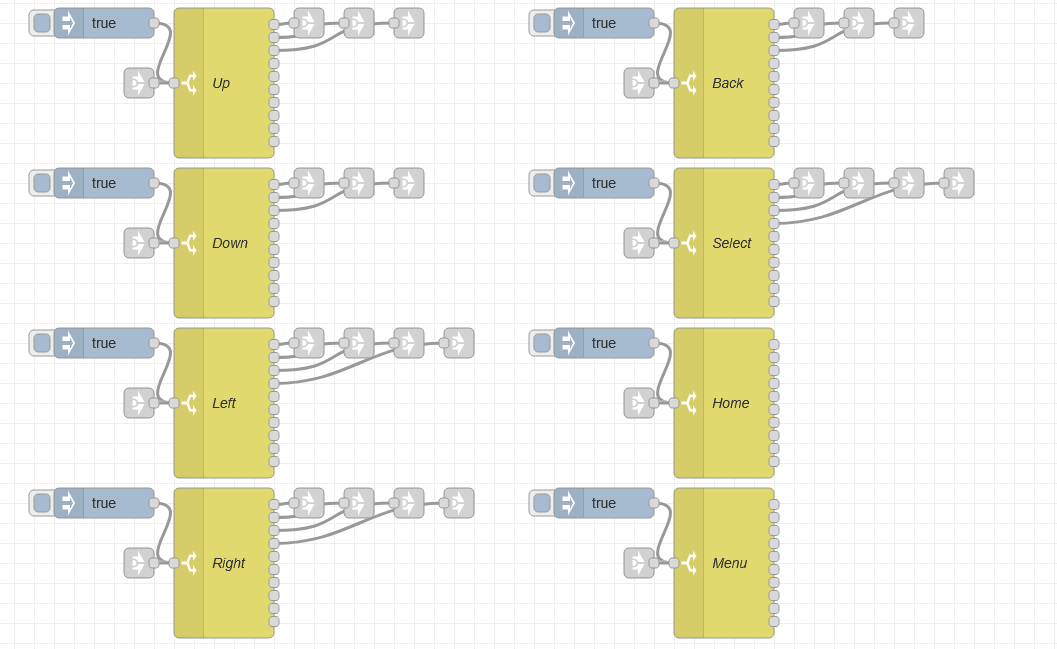

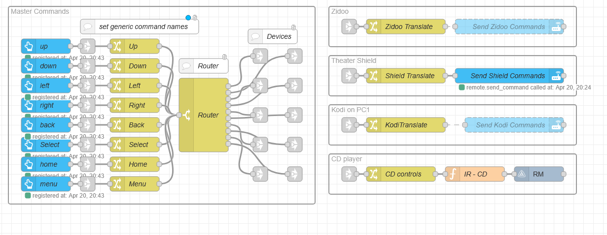

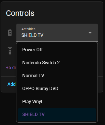

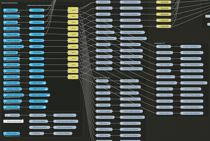

Flow for button.* entities to route to the correct Harmony Activity
- Ethos behind this is it uses one button.* entity mapped to the remote, NodeRED does the Activity detection and routes the button presses to the right device.

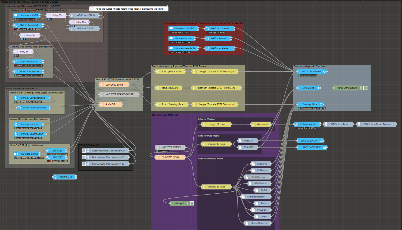

Flow for ethernet (RS232) control of NAD Amplifier
- Ethos behind this is button.* entities directly control volume, surround sound mode and starting volume of the amplifier

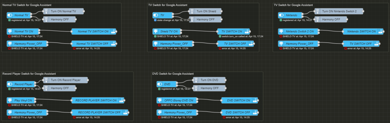

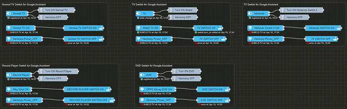

Flow for voice control switches that switch between Harmony Activities
- These now control HA Assist not just Google Assistant
- Activity switching between Harmony activities works well with voice control on this one. I usually request “Turn TV ON”, “Turn TV OFF”, “Turn DVD ON”, Turn DVD OFF” when switching but it will directly switch between activities.
[{"id":"c37b651550628148","type":"group","z":"fbc96b6cec386837","name":"TV Switch for Google Assistant","style":{"label":true},"nodes":["5b6864f187884333","27a6954d539c7a10","d56b0577d5fc2d33","3a65669303d1dbf8","ea33ada073e6af47","e8430ca818da53ee","5f3ec2aacb65b008"],"x":1594,"y":3299,"w":552,"h":242},{"id":"5b6864f187884333","type":"H activity","z":"fbc96b6cec386837","g":"c37b651550628148","name":"Turn ON Shield","server":"21dd4f96b9a6b12b","activity":"48067014","label":"SHIELD TV","x":1880,"y":3340,"wires":[[]]},{"id":"27a6954d539c7a10","type":"H activity","z":"fbc96b6cec386837","g":"c37b651550628148","name":"Harmony OFF","server":"21dd4f96b9a6b12b","activity":"-1","label":"PowerOff","x":1880,"y":3380,"wires":[[]]},{"id":"d56b0577d5fc2d33","type":"ha-switch","z":"fbc96b6cec386837","g":"c37b651550628148","name":"TV","version":0,"debugenabled":false,"inputs":0,"outputs":2,"entityConfig":"fe79d7fb9b892728","enableInput":false,"outputOnStateChange":true,"outputProperties":[{"property":"outputType","propertyType":"msg","value":"state change","valueType":"str"},{"property":"payload","propertyType":"msg","value":"string","valueType":"entityState"}],"x":1670,"y":3360,"wires":[["5b6864f187884333"],["27a6954d539c7a10"]]},{"id":"3a65669303d1dbf8","type":"trigger-state","z":"fbc96b6cec386837","g":"c37b651550628148","name":"Shield TV ON","server":"bb380e72.b8825","version":5,"inputs":0,"outputs":2,"exposeAsEntityConfig":"","entities":{"entity":["select.harmony_hub_activities"],"substring":[],"regex":[]},"debugEnabled":false,"constraints":[{"targetType":"this_entity","targetValue":"","propertyType":"current_state","propertyValue":"new_state.state","comparatorType":"is","comparatorValueDatatype":"str","comparatorValue":"SHIELD TV"}],"customOutputs":[],"outputInitially":true,"stateType":"str","enableInput":false,"x":1690,"y":3440,"wires":[["5f3ec2aacb65b008"],[]]},{"id":"ea33ada073e6af47","type":"trigger-state","z":"fbc96b6cec386837","g":"c37b651550628148","name":"Harmony Power_OFF","server":"bb380e72.b8825","version":5,"inputs":0,"outputs":2,"exposeAsEntityConfig":"","entities":{"entity":["select.harmony_hub_activities"],"substring":[],"regex":[]},"debugEnabled":false,"constraints":[{"targetType":"this_entity","targetValue":"","propertyType":"current_state","propertyValue":"new_state.state","comparatorType":"is","comparatorValueDatatype":"str","comparatorValue":"power_off"}],"customOutputs":[],"outputInitially":true,"stateType":"str","enableInput":false,"x":1720,"y":3500,"wires":[["e8430ca818da53ee"],[]]},{"id":"e8430ca818da53ee","type":"api-call-service","z":"fbc96b6cec386837","g":"c37b651550628148","name":"TV SWITCH OFF","server":"bb380e72.b8825","version":7,"debugenabled":false,"action":"switch.turn_off","floorId":[],"areaId":[],"deviceId":[],"entityId":["switch.tv"],"labelId":[],"data":"","dataType":"jsonata","mergeContext":"","mustacheAltTags":false,"outputProperties":[],"queue":"none","blockInputOverrides":true,"domain":"switch","service":"turn_off","x":2030,"y":3500,"wires":[[]]},{"id":"5f3ec2aacb65b008","type":"api-call-service","z":"fbc96b6cec386837","g":"c37b651550628148","name":"TV SWITCH ON","server":"bb380e72.b8825","version":7,"debugenabled":false,"action":"switch.turn_on","floorId":[],"areaId":[],"deviceId":[],"entityId":["switch.tv"],"labelId":[],"data":"","dataType":"jsonata","mergeContext":"","mustacheAltTags":false,"outputProperties":[],"queue":"none","blockInputOverrides":true,"domain":"switch","service":"turn_on","x":2020,"y":3440,"wires":[[]]},{"id":"21dd4f96b9a6b12b","type":"harmony-server","name":"Living Room Hub","ip":"192.168.1.252"},{"id":"fe79d7fb9b892728","type":"ha-entity-config","server":"bb380e72.b8825","deviceConfig":"e3d65fbe01b3b8d9","name":"TV","version":"6","entityType":"switch","haConfig":[{"property":"name","value":"TV"},{"property":"icon","value":"phu:nvidia-shield"},{"property":"entity_picture","value":""},{"property":"entity_category","value":""},{"property":"device_class","value":"switch"}],"resend":false,"debugEnabled":false},{"id":"bb380e72.b8825","type":"server","name":"Home Assistant","version":6,"addon":true,"rejectUnauthorizedCerts":true,"ha_boolean":["y","yes","true","on","home","open"],"connectionDelay":true,"cacheJson":true,"heartbeat":false,"heartbeatInterval":"30","areaSelector":"friendlyName","deviceSelector":"friendlyName","entitySelector":"friendlyName","statusSeparator":"at: ","statusYear":"hidden","statusMonth":"short","statusDay":"numeric","statusHourCycle":"h23","statusTimeFormat":"h:m","enableGlobalContextStore":true},{"id":"e3d65fbe01b3b8d9","type":"ha-device-config","name":"TV","hwVersion":"","manufacturer":"Node-RED","model":"","swVersion":""},{"id":"778dac2c6d1894e1","type":"group","z":"fbc96b6cec386837","name":"Record Player Switch for Google Assistant","style":{"label":true},"nodes":["9b34b18fa6a58e0c","445985655571c0d2","2ea0c9698faebb6c","2b21cf6aa173a74d","aacaf123d4167033","ccbf84cdc0e6c256","f2a7e1a71bb9a0a2"],"x":874,"y":3639,"w":652,"h":242},{"id":"9b34b18fa6a58e0c","type":"H activity","z":"fbc96b6cec386837","g":"778dac2c6d1894e1","name":"Turn ON Record Player","server":"21dd4f96b9a6b12b","activity":"39069297","label":"Play Vinyl","x":1190,"y":3680,"wires":[[]]},{"id":"445985655571c0d2","type":"H activity","z":"fbc96b6cec386837","g":"778dac2c6d1894e1","name":"Harmony OFF","server":"21dd4f96b9a6b12b","activity":"-1","label":"PowerOff","x":1160,"y":3720,"wires":[[]]},{"id":"2ea0c9698faebb6c","type":"ha-switch","z":"fbc96b6cec386837","g":"778dac2c6d1894e1","name":"Record Player","version":0,"debugenabled":false,"inputs":0,"outputs":2,"entityConfig":"57b89ad6209b60ea","enableInput":false,"outputOnStateChange":true,"outputProperties":[{"property":"outputType","propertyType":"msg","value":"state change","valueType":"str"},{"property":"payload","propertyType":"msg","value":"string","valueType":"entityState"}],"x":970,"y":3700,"wires":[["9b34b18fa6a58e0c"],["445985655571c0d2"]]},{"id":"2b21cf6aa173a74d","type":"trigger-state","z":"fbc96b6cec386837","g":"778dac2c6d1894e1","name":"Play Vinyl ON","server":"bb380e72.b8825","version":5,"inputs":0,"outputs":2,"exposeAsEntityConfig":"","entities":{"entity":["select.harmony_hub_activities"],"substring":[],"regex":[]},"debugEnabled":false,"constraints":[{"targetType":"this_entity","targetValue":"","propertyType":"current_state","propertyValue":"new_state.state","comparatorType":"is","comparatorValueDatatype":"str","comparatorValue":"Play Vinyl"}],"customOutputs":[],"outputInitially":true,"stateType":"str","enableInput":false,"x":970,"y":3780,"wires":[["f2a7e1a71bb9a0a2"],[]]},{"id":"aacaf123d4167033","type":"trigger-state","z":"fbc96b6cec386837","g":"778dac2c6d1894e1","name":"Harmony Power_OFF","server":"bb380e72.b8825","version":5,"inputs":0,"outputs":2,"exposeAsEntityConfig":"","entities":{"entity":["select.harmony_hub_activities"],"substring":[],"regex":[]},"debugEnabled":false,"constraints":[{"targetType":"this_entity","targetValue":"","propertyType":"current_state","propertyValue":"new_state.state","comparatorType":"is","comparatorValueDatatype":"str","comparatorValue":"power_off"}],"customOutputs":[],"outputInitially":true,"stateType":"str","enableInput":false,"x":1000,"y":3840,"wires":[["ccbf84cdc0e6c256"],[]]},{"id":"ccbf84cdc0e6c256","type":"api-call-service","z":"fbc96b6cec386837","g":"778dac2c6d1894e1","name":"RECORD PLAYER SWITCH OFF","server":"bb380e72.b8825","version":7,"debugenabled":false,"action":"switch.turn_off","floorId":[],"areaId":[],"deviceId":[],"entityId":["switch.record_player"],"labelId":[],"data":"","dataType":"jsonata","mergeContext":"","mustacheAltTags":false,"outputProperties":[],"queue":"none","blockInputOverrides":true,"domain":"switch","service":"turn_off","x":1360,"y":3840,"wires":[[]]},{"id":"f2a7e1a71bb9a0a2","type":"api-call-service","z":"fbc96b6cec386837","g":"778dac2c6d1894e1","name":"RECORD PLAYER SWITCH ON","server":"bb380e72.b8825","version":7,"debugenabled":false,"action":"switch.turn_on","floorId":[],"areaId":[],"deviceId":[],"entityId":["switch.record_player"],"labelId":[],"data":"","dataType":"jsonata","mergeContext":"","mustacheAltTags":false,"outputProperties":[],"queue":"none","blockInputOverrides":true,"domain":"switch","service":"turn_on","x":1350,"y":3780,"wires":[[]]},{"id":"57b89ad6209b60ea","type":"ha-entity-config","server":"bb380e72.b8825","deviceConfig":"7e50d0c1b174e8f7","name":"Record Player","version":"6","entityType":"switch","haConfig":[{"property":"name","value":"Record Player"},{"property":"icon","value":"mdi:record_player"},{"property":"entity_picture","value":""},{"property":"entity_category","value":""},{"property":"device_class","value":"switch"}],"resend":false,"debugEnabled":false},{"id":"7e50d0c1b174e8f7","type":"ha-device-config","name":"Record Player","hwVersion":"","manufacturer":"Node-RED","model":"","swVersion":""},{"id":"e09463b843f53cd3","type":"group","z":"fbc96b6cec386837","name":"DVD Switch for Google Assistant","style":{"label":true},"nodes":["1801db280d6ce79d","4ef610b56284fd80","6b57d235d028d9b8","c2ba4391fb0032d8","1dbe4aa21f4877f1","17fdd8d947e37ca7","a18a7207411e2f71"],"x":1614,"y":3639,"w":552,"h":242},{"id":"1801db280d6ce79d","type":"H activity","z":"fbc96b6cec386837","g":"e09463b843f53cd3","name":"Turn ON DVD","server":"21dd4f96b9a6b12b","activity":"30822006","label":"OPPO Bluray DVD","x":1900,"y":3680,"wires":[[]]},{"id":"4ef610b56284fd80","type":"H activity","z":"fbc96b6cec386837","g":"e09463b843f53cd3","name":"Harmony OFF","server":"21dd4f96b9a6b12b","activity":"-1","label":"PowerOff","x":1900,"y":3720,"wires":[[]]},{"id":"6b57d235d028d9b8","type":"ha-switch","z":"fbc96b6cec386837","g":"e09463b843f53cd3","name":"DVD","version":0,"debugenabled":false,"inputs":0,"outputs":2,"entityConfig":"b5c641c8471ca970","enableInput":false,"outputOnStateChange":true,"outputProperties":[{"property":"outputType","propertyType":"msg","value":"state change","valueType":"str"},{"property":"payload","propertyType":"msg","value":"string","valueType":"entityState"}],"x":1690,"y":3700,"wires":[["1801db280d6ce79d"],["4ef610b56284fd80"]]},{"id":"c2ba4391fb0032d8","type":"trigger-state","z":"fbc96b6cec386837","g":"e09463b843f53cd3","name":"OPPO Bluray DVD ON","server":"bb380e72.b8825","version":5,"inputs":0,"outputs":2,"exposeAsEntityConfig":"","entities":{"entity":["select.harmony_hub_activities"],"substring":[],"regex":[]},"debugEnabled":false,"constraints":[{"targetType":"this_entity","targetValue":"","propertyType":"current_state","propertyValue":"new_state.state","comparatorType":"is","comparatorValueDatatype":"str","comparatorValue":"OPPO Bluray DVD"}],"customOutputs":[],"outputInitially":true,"stateType":"str","enableInput":false,"x":1740,"y":3780,"wires":[["a18a7207411e2f71"],[]]},{"id":"1dbe4aa21f4877f1","type":"trigger-state","z":"fbc96b6cec386837","g":"e09463b843f53cd3","name":"Harmony Power_OFF","server":"bb380e72.b8825","version":5,"inputs":0,"outputs":2,"exposeAsEntityConfig":"","entities":{"entity":["select.harmony_hub_activities"],"substring":[],"regex":[]},"debugEnabled":false,"constraints":[{"targetType":"this_entity","targetValue":"","propertyType":"current_state","propertyValue":"new_state.state","comparatorType":"is","comparatorValueDatatype":"str","comparatorValue":"power_off"}],"customOutputs":[],"outputInitially":true,"stateType":"str","enableInput":false,"x":1740,"y":3840,"wires":[["17fdd8d947e37ca7"],[]]},{"id":"17fdd8d947e37ca7","type":"api-call-service","z":"fbc96b6cec386837","g":"e09463b843f53cd3","name":"DVD SWITCH OFF","server":"bb380e72.b8825","version":7,"debugenabled":false,"action":"switch.turn_off","floorId":[],"areaId":[],"deviceId":[],"entityId":["switch.dvd"],"labelId":[],"data":"","dataType":"jsonata","mergeContext":"","mustacheAltTags":false,"outputProperties":[],"queue":"none","blockInputOverrides":true,"domain":"switch","service":"turn_off","x":2050,"y":3840,"wires":[[]]},{"id":"a18a7207411e2f71","type":"api-call-service","z":"fbc96b6cec386837","g":"e09463b843f53cd3","name":"DVD SWITCH ON","server":"bb380e72.b8825","version":7,"debugenabled":false,"action":"switch.turn_on","floorId":[],"areaId":[],"deviceId":[],"entityId":["switch.dvd"],"labelId":[],"data":"","dataType":"jsonata","mergeContext":"","mustacheAltTags":false,"outputProperties":[],"queue":"none","blockInputOverrides":true,"domain":"switch","service":"turn_on","x":2050,"y":3780,"wires":[[]]},{"id":"b5c641c8471ca970","type":"ha-entity-config","server":"bb380e72.b8825","deviceConfig":"5608ffb005953ad8","name":"DVD","version":"6","entityType":"switch","haConfig":[{"property":"name","value":"DVD"},{"property":"icon","value":"phu:dvd"},{"property":"entity_picture","value":""},{"property":"entity_category","value":""},{"property":"device_class","value":"switch"}],"resend":false,"debugEnabled":false},{"id":"5608ffb005953ad8","type":"ha-device-config","name":"DVD","hwVersion":"","manufacturer":"Node-RED","model":"","swVersion":""},{"id":"1cee3971a9b06a50","type":"group","z":"fbc96b6cec386837","name":"Normal TV Switch for Google Assistant","style":{"label":true},"nodes":["8a5b49a102c92b3a","fd8346e7327463d7","668d32dbd694622a","20d1c3148cea2d6c","c519995fc8b5f70c","67a3bb1a73073428","093e146cbd2c2e10"],"x":874,"y":3299,"w":592,"h":242},{"id":"8a5b49a102c92b3a","type":"H activity","z":"fbc96b6cec386837","g":"1cee3971a9b06a50","name":"Turn ON Normal TV","server":"21dd4f96b9a6b12b","activity":"42679719","label":"Normal TV","x":1180,"y":3340,"wires":[[]]},{"id":"fd8346e7327463d7","type":"H activity","z":"fbc96b6cec386837","g":"1cee3971a9b06a50","name":"Harmony OFF","server":"21dd4f96b9a6b12b","activity":"-1","label":"PowerOff","x":1160,"y":3380,"wires":[[]]},{"id":"668d32dbd694622a","type":"ha-switch","z":"fbc96b6cec386837","g":"1cee3971a9b06a50","name":"Normal TV","version":0,"debugenabled":false,"inputs":0,"outputs":2,"entityConfig":"ecdc8ff7518bb0d8","enableInput":false,"outputOnStateChange":true,"outputProperties":[{"property":"outputType","propertyType":"msg","value":"state change","valueType":"str"},{"property":"payload","propertyType":"msg","value":"string","valueType":"entityState"}],"x":960,"y":3360,"wires":[["8a5b49a102c92b3a"],["fd8346e7327463d7"]]},{"id":"20d1c3148cea2d6c","type":"trigger-state","z":"fbc96b6cec386837","g":"1cee3971a9b06a50","name":"Normal TV ON","server":"bb380e72.b8825","version":5,"inputs":0,"outputs":2,"exposeAsEntityConfig":"","entities":{"entity":["select.harmony_hub_activities"],"substring":[],"regex":[]},"debugEnabled":false,"constraints":[{"targetType":"this_entity","targetValue":"","propertyType":"current_state","propertyValue":"new_state.state","comparatorType":"is","comparatorValueDatatype":"str","comparatorValue":"Normal TV"}],"customOutputs":[],"outputInitially":true,"stateType":"str","enableInput":false,"x":980,"y":3440,"wires":[["093e146cbd2c2e10"],[]]},{"id":"c519995fc8b5f70c","type":"trigger-state","z":"fbc96b6cec386837","g":"1cee3971a9b06a50","name":"Harmony Power_OFF","server":"bb380e72.b8825","version":5,"inputs":0,"outputs":2,"exposeAsEntityConfig":"","entities":{"entity":["select.harmony_hub_activities"],"substring":[],"regex":[]},"debugEnabled":false,"constraints":[{"targetType":"this_entity","targetValue":"","propertyType":"current_state","propertyValue":"new_state.state","comparatorType":"is","comparatorValueDatatype":"str","comparatorValue":"power_off"}],"customOutputs":[],"outputInitially":true,"stateType":"str","enableInput":false,"x":1000,"y":3500,"wires":[["67a3bb1a73073428"],[]]},{"id":"67a3bb1a73073428","type":"api-call-service","z":"fbc96b6cec386837","g":"1cee3971a9b06a50","name":"Normal TV SWITCH OFF","server":"bb380e72.b8825","version":7,"debugenabled":false,"action":"switch.turn_off","floorId":[],"areaId":[],"deviceId":[],"entityId":["switch.normal_tv"],"labelId":[],"data":"","dataType":"jsonata","mergeContext":"","mustacheAltTags":false,"outputProperties":[],"queue":"none","blockInputOverrides":true,"domain":"switch","service":"turn_off","x":1330,"y":3500,"wires":[[]]},{"id":"093e146cbd2c2e10","type":"api-call-service","z":"fbc96b6cec386837","g":"1cee3971a9b06a50","name":"Normal TV SWITCH ON","server":"bb380e72.b8825","version":7,"debugenabled":false,"action":"switch.turn_on","floorId":[],"areaId":[],"deviceId":[],"entityId":["switch.normal_tv"],"labelId":[],"data":"","dataType":"jsonata","mergeContext":"","mustacheAltTags":false,"outputProperties":[],"queue":"none","blockInputOverrides":true,"domain":"switch","service":"turn_on","x":1330,"y":3440,"wires":[[]]},{"id":"ecdc8ff7518bb0d8","type":"ha-entity-config","server":"bb380e72.b8825","deviceConfig":"f03ec738168a5393","name":"Normal TV","version":"6","entityType":"switch","haConfig":[{"property":"name","value":"Normal TV"},{"property":"icon","value":"mdi:television-classic"},{"property":"entity_picture","value":""},{"property":"entity_category","value":""},{"property":"device_class","value":"switch"}],"resend":false,"debugEnabled":false},{"id":"f03ec738168a5393","type":"ha-device-config","name":"Normal TV","hwVersion":"","manufacturer":"Node-RED","model":"","swVersion":""},{"id":"f4c939a297447b4d","type":"group","z":"fbc96b6cec386837","name":"TV Switch for Google Assistant","style":{"label":true},"nodes":["19f1aa8ce3208d8e","d6b31d05f74558b6","d3587d77de3887eb","ef8ce856b3840815","b54a6bab1e63fa74","e6145ac6e38f9c79","794d254c70093e34"],"x":2214,"y":3299,"w":572,"h":242},{"id":"19f1aa8ce3208d8e","type":"H activity","z":"fbc96b6cec386837","g":"f4c939a297447b4d","name":"Turn ON Nintendo Switch 2","server":"21dd4f96b9a6b12b","activity":"53662309","label":"Nintendo Switch 2","x":2540,"y":3340,"wires":[[]]},{"id":"d6b31d05f74558b6","type":"H activity","z":"fbc96b6cec386837","g":"f4c939a297447b4d","name":"Harmony OFF","server":"21dd4f96b9a6b12b","activity":"-1","label":"PowerOff","x":2500,"y":3380,"wires":[[]]},{"id":"d3587d77de3887eb","type":"ha-switch","z":"fbc96b6cec386837","g":"f4c939a297447b4d","name":"Nintendo","version":0,"debugenabled":false,"inputs":0,"outputs":2,"entityConfig":"9a2e6ea3b691b804","enableInput":false,"outputOnStateChange":true,"outputProperties":[{"property":"outputType","propertyType":"msg","value":"state change","valueType":"str"},{"property":"payload","propertyType":"msg","value":"string","valueType":"entityState"}],"x":2300,"y":3360,"wires":[["19f1aa8ce3208d8e"],["d6b31d05f74558b6"]]},{"id":"ef8ce856b3840815","type":"trigger-state","z":"fbc96b6cec386837","g":"f4c939a297447b4d","name":"Nintendo Switch 2 ON","server":"bb380e72.b8825","version":5,"inputs":0,"outputs":2,"exposeAsEntityConfig":"","entities":{"entity":["select.harmony_hub_activities"],"substring":[],"regex":[]},"debugEnabled":false,"constraints":[{"targetType":"this_entity","targetValue":"","propertyType":"current_state","propertyValue":"new_state.state","comparatorType":"is","comparatorValueDatatype":"str","comparatorValue":"Nintendo Switch 2"}],"customOutputs":[],"outputInitially":true,"stateType":"str","enableInput":false,"x":2340,"y":3440,"wires":[["794d254c70093e34"],[]]},{"id":"b54a6bab1e63fa74","type":"trigger-state","z":"fbc96b6cec386837","g":"f4c939a297447b4d","name":"Harmony Power_OFF","server":"bb380e72.b8825","version":5,"inputs":0,"outputs":2,"exposeAsEntityConfig":"","entities":{"entity":["select.harmony_hub_activities"],"substring":[],"regex":[]},"debugEnabled":false,"constraints":[{"targetType":"this_entity","targetValue":"","propertyType":"current_state","propertyValue":"new_state.state","comparatorType":"is","comparatorValueDatatype":"str","comparatorValue":"power_off"}],"customOutputs":[],"outputInitially":true,"stateType":"str","enableInput":false,"x":2340,"y":3500,"wires":[["e6145ac6e38f9c79"],[]]},{"id":"e6145ac6e38f9c79","type":"api-call-service","z":"fbc96b6cec386837","g":"f4c939a297447b4d","name":"TV SWITCH OFF","server":"bb380e72.b8825","version":7,"debugenabled":false,"action":"switch.turn_off","floorId":[],"areaId":[],"deviceId":[],"entityId":["switch.nintendo"],"labelId":[],"data":"","dataType":"jsonata","mergeContext":"","mustacheAltTags":false,"outputProperties":[],"queue":"none","blockInputOverrides":true,"domain":"switch","service":"turn_off","x":2650,"y":3500,"wires":[[]]},{"id":"794d254c70093e34","type":"api-call-service","z":"fbc96b6cec386837","g":"f4c939a297447b4d","name":"Nintendo SWITCH ON","server":"bb380e72.b8825","version":7,"debugenabled":false,"action":"switch.turn_on","floorId":[],"areaId":[],"deviceId":[],"entityId":["switch.nintendo"],"labelId":[],"data":"","dataType":"jsonata","mergeContext":"","mustacheAltTags":false,"outputProperties":[],"queue":"none","blockInputOverrides":true,"domain":"switch","service":"turn_on","x":2660,"y":3440,"wires":[[]]},{"id":"9a2e6ea3b691b804","type":"ha-entity-config","server":"bb380e72.b8825","deviceConfig":"c3d07af1c382fa6b","name":"Nintendo","version":6,"entityType":"switch","haConfig":[{"property":"name","value":"Nintendo"},{"property":"icon","value":"phu:nintendo-switch-logo"},{"property":"entity_picture","value":""},{"property":"entity_category","value":""},{"property":"device_class","value":"switch"}],"resend":false,"debugEnabled":false},{"id":"c3d07af1c382fa6b","type":"ha-device-config","name":"Nintendo","hwVersion":"","manufacturer":"Node-RED","model":"Nintendo","swVersion":""},{"id":"4e09994d44924ee9","type":"global-config","env":[],"modules":{"node-red-contrib-harmony-extra":"1.0.1","node-red-contrib-home-assistant-websocket":"0.80.3"}}]
