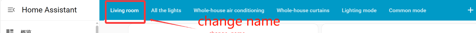

:four: Rename Dashboard View
  • Avoid “Default” or “Home” as the view name
  • Choose a unique name like Remote, Astrion, or Control
  • Refresh the dashboard and reconnect
