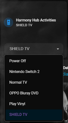

@Charles You really need to allow the Astrion to select Harmony Activities.
I rely on what I have already programed into the Harmony Hub to mange the sequence of ON, OFF and Switching between Activities. I have 5 components that need to be managed in a particular order. Activities built into the Harmony Hub is the best and simplest way to do this.
Adding this ability to the Astrion will allow direct control of the Harmony Hub device that is in Home Assistant. Re-enforcing the Astrions UI only ethos. At the moment the TV ROS Card is only good for direct control of Android TV or Apple TV Devices
This will also keep the Astrion in sync with the Harmony Remote and status of the Harmony Hub device in Home Assistant.
Your script solution is NOT GOOD ENOUGH and duplicates automation that already exists in the Harmony Hub.
Adding a simple dropdown selector to the Astrion that replaces the Power Toggle on the TV ROS Card is the solution you need to implement. Also allowing *.button entities to be directly mapped to the TV ROS card hardware buttons would help.
You need to add a Harmony Device Type in addition to the Android TV or Apple TV Devices in your TV ROS Card. This should allow clean separation between the power behavior of the different devices.

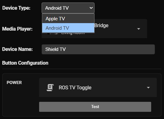

The ROS TV Card needs three selectable options for the power button.
  1. Current implementation - Power Button acting on the Android TV or Apple TV device
  2. Separate ON/OFF Commands. Ability to select separate ON and OFF commands i.e. ON - Harmony TV Activity, OFF - Harmony Off or This also could act on the Harmony Hub device itself toggling the switch ON and OFF.
  3. Dropdown Activity selector - Add a dropdown list where you can select the Harmony Activity from the remotes on screen UI.
To implement this properly:
  • Options 1. and 2. need to be selectable for the power button behaviour.
  • Option 3. needs to be added so you can select it from the remote UI.
One of the main issues here is the Astrion does not allow the ROS TV Card to control standard HA Entities. Scripts work but Switches, Buttons and Dropdown Select entities do not work. If they just get the ROS Card to control these entities correctly the user will be able to configure what they need.

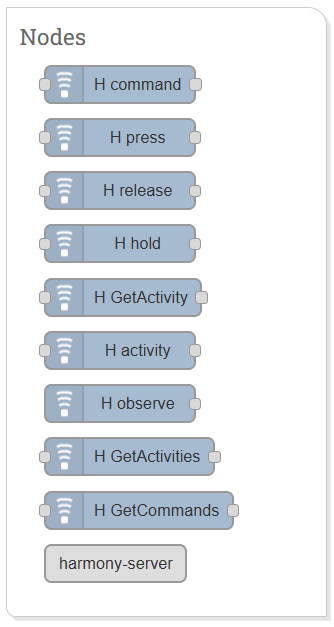

“Press and hold” is also currently not properly supported, many devices require this but the current method of passing button press commands to HA doesn’t allow for this in many cases, this is a bit of a HA limitation but there must be some way to improve it if other devices like sofabaton can make it work reasonably well. some devices will interpret a repeating press as a held button, but others really need a separate Press/Held/Release command set.

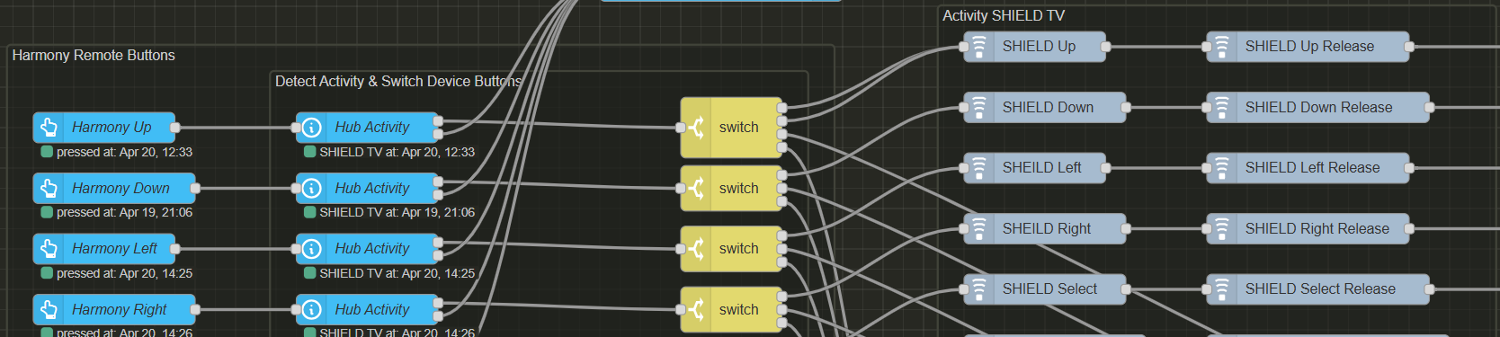

Curently in my NodeRed Harmony Button Mapper flow I have the press and release function. Required to ensure there is only a single button press when requested.
so how are you translating the Astrion single button press to a press and release? a looping script?
Press and release are nodes in node-red-contrib-harmony-extra
Press and release gets pressed sequentially in the flow.
