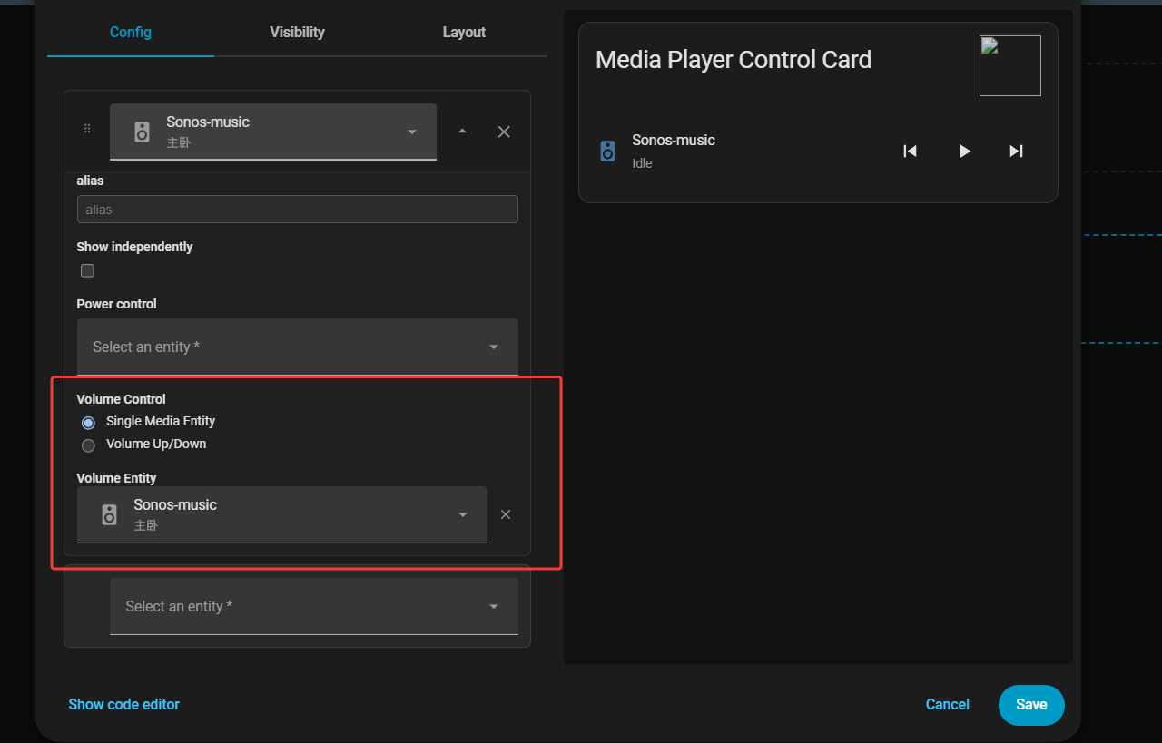

Regarding a standalone media player card — if you only need volume button mapping, that can be done. But if you need to map other buttons as well, then there’s no way to do that.
For now, regarding media player control button mapping, here are three workarounds I would suggest:
Option 1: Bind the media player device inside the TV Card. This allows you to use the TV Card button mapping, but the downside is that you cannot jump directly to the media player interface — you need to swipe manually.
Option 2: Use a standalone Media Player Card. It supports volume button mapping, but the downside is that you cannot map any other buttons besides the volume buttons.
Option 3: Add the media player device as a separate TV Card. This allows full button mapping and direct navigation, but the downside is that the touchscreen interface will be the standard TV interface rather than the media player interface.
