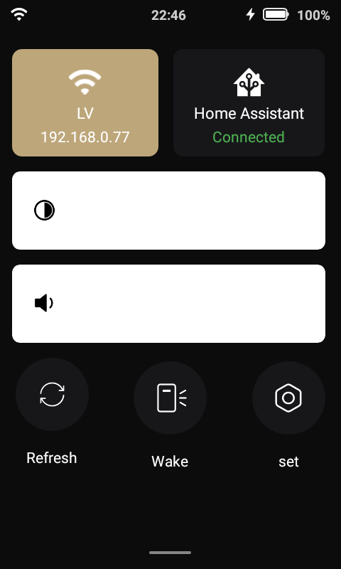

Hi, I just tested this. My main network and Home Assistant are both on the 110 subnet (HA IP: 192.168.110.245). My Astrion remote and my phone are both on the 0 subnet, which is a subnetwork of 110. When I entered the HA IP on the 110 subnet along with the Token, I was able to log in without any issues. Is this what you were aiming for?
Hi, no, the remote itself when inputting the IP or hostname for the Home Assistant instance connects fine. I can see the cards etc as expected on the remote.

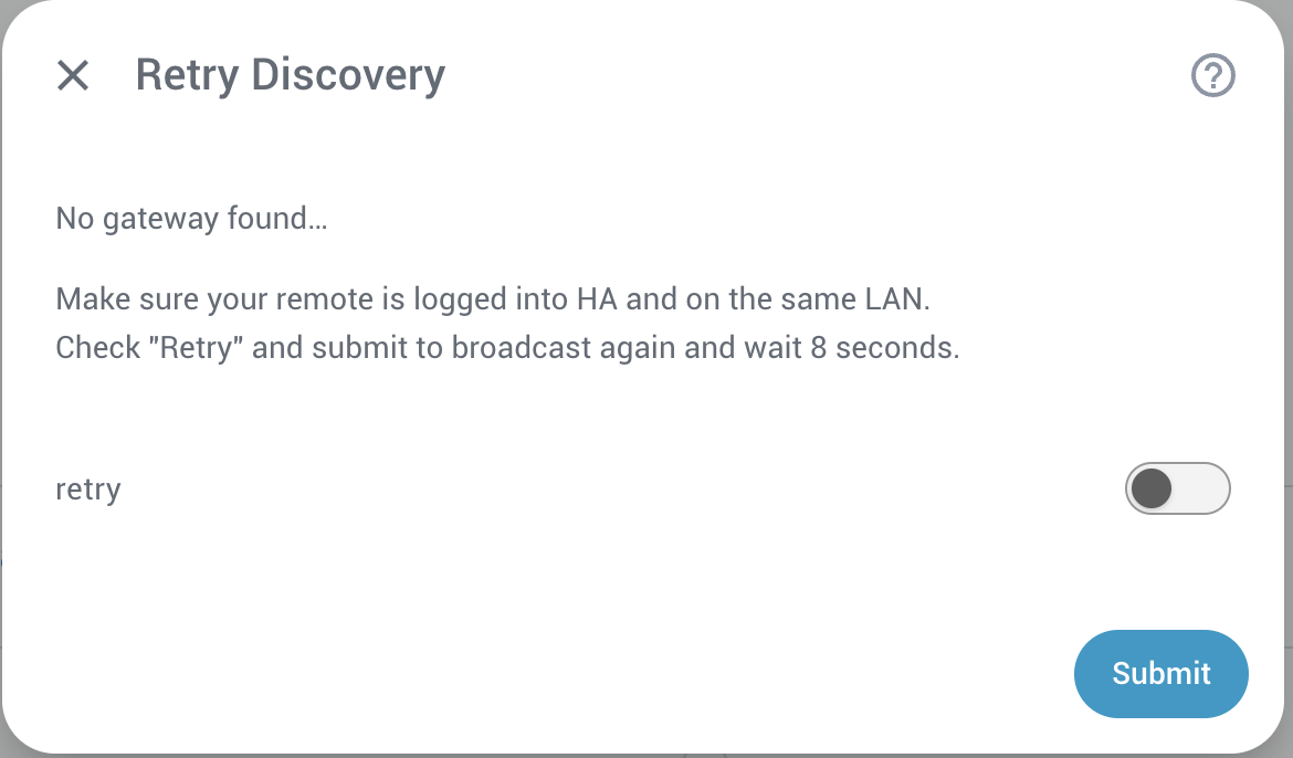

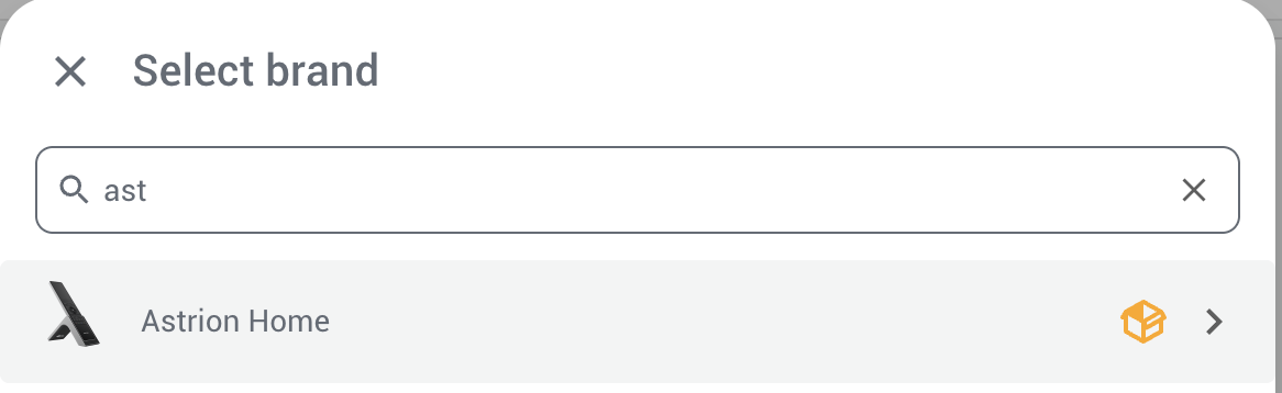

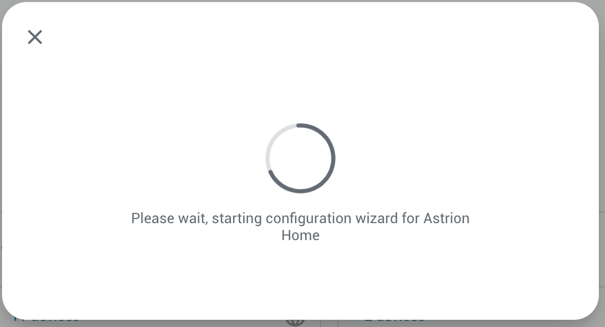

I’m talking about the adding of the remote to the Astrion Home integration. After installing the integration via HACS, you then add the integration and it does a discovery, which fails. My belief looking at logs is that this is because the integration is looking for the remote and isn’t multi-subnet aware - rather than looking for a token to check in as advised above. The error message even states “make sure it’s on the same LAN”, which as I said, it’s not as it’s on a separate VLAN and subnet - not just a different subnet on the same VLAN.

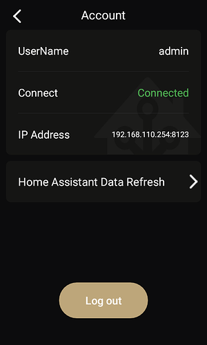

Quick question — does the account linked to your remote’s login token have admin rights?
If it’s a standard user account, could you try upgrading it to admin? Once you do, restart the remote (it’ll log back in automatically), and then give the connection another shot. Let us know if that resolves it!
@Leewei device ID is 0127A260301T0482 and have replicated issue a few times after enabling logging.

Happy to move this to a dedicated thread, but AFAIK tokens don’t have rights as such.
However, upon logging out and back in with a new token, the remote is now being found
Great to hear your update — congratulations on getting the remote discovered and working!:partying_face:
We will share the issue and the solution you provided with our after-sales support team, so that if other users run into a similar situation in the future, we can offer them this helpful approach.
Many thanks for sharing this with us!:laughing:

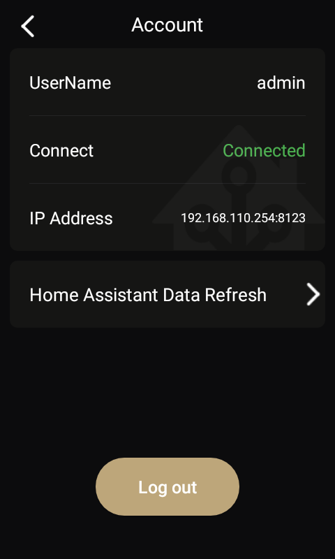

Hello,
Regarding your issues, here are some explanations and solutions:
1. Device Discovery Issue
First, the Token used to log in to your remote must have administrator privileges in order for the device to be discovered in the integration.
If you have confirmed that you are using an administrator account and both devices are on the same local network, please log out of the current Token, create a new one, and try connecting again. You can refer to this support guide for detailed steps:
