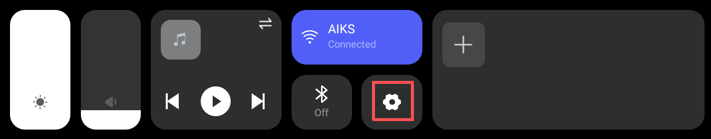

If you would like to switch Wi-Fi networks, simply swipe down to open the notification panel, then press and hold the Wi-Fi icon to access the Wi-Fi settings.

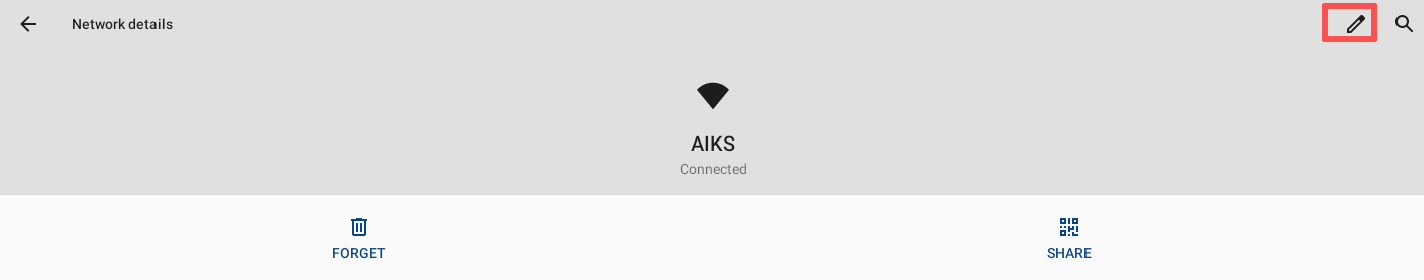

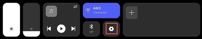

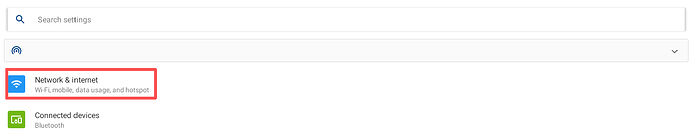

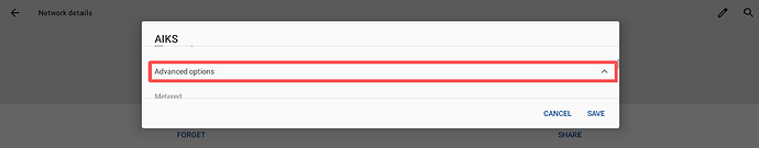

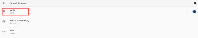

Swipe down to open the notification panel and press and hold the “Settings” icon → tap “Network Settings” → select the connected Wi-Fi network → tap the Edit button in the upper-right corner of the Wi-Fi details page → scroll down and expand “Advanced options” → set “IP settings” to “Static” → enter the new IP address.
Note: While navigating through the settings, we recommend dragging the scrollbar directly to quickly locate the relevant options.
Please refer to the images below for detailed instructions.
