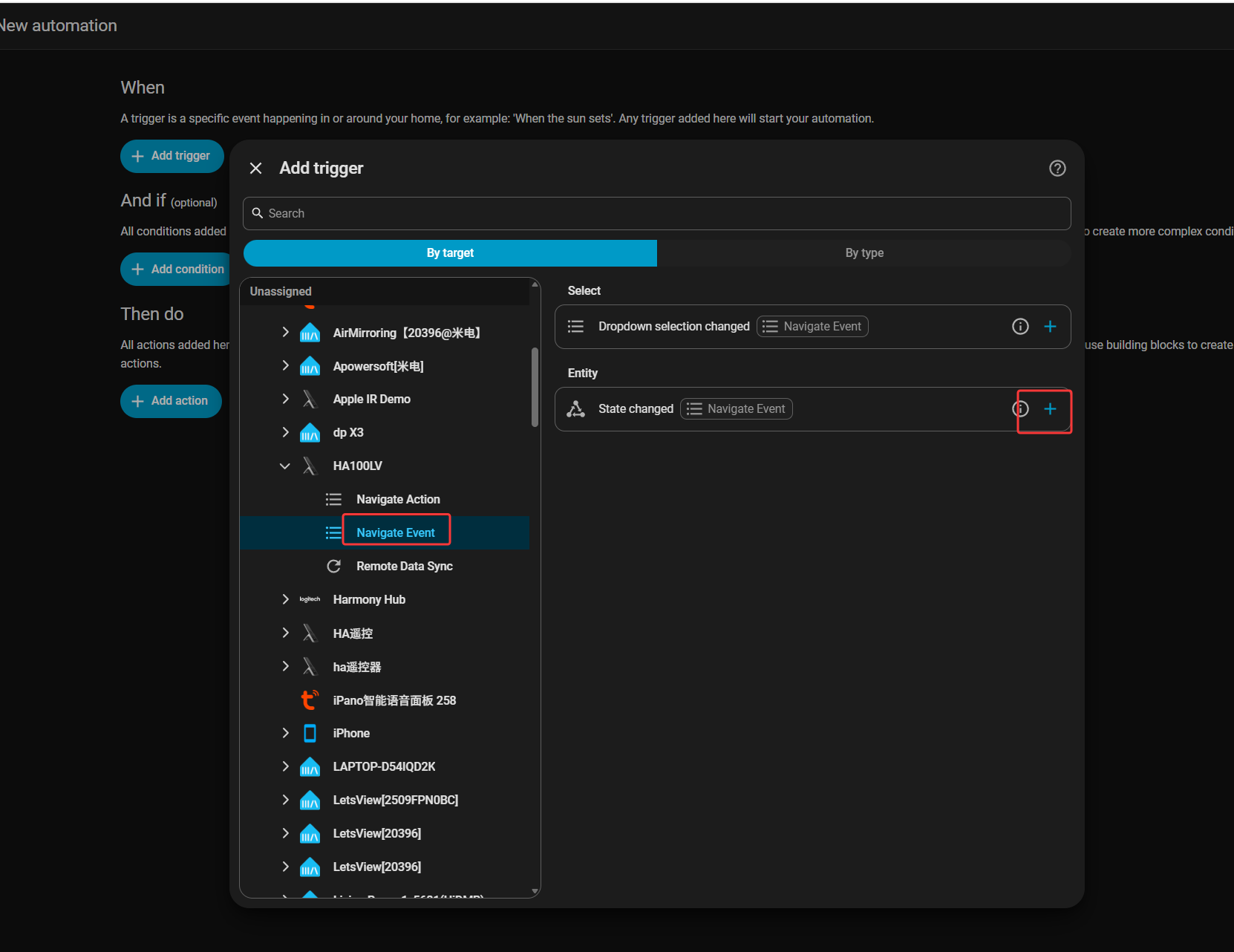

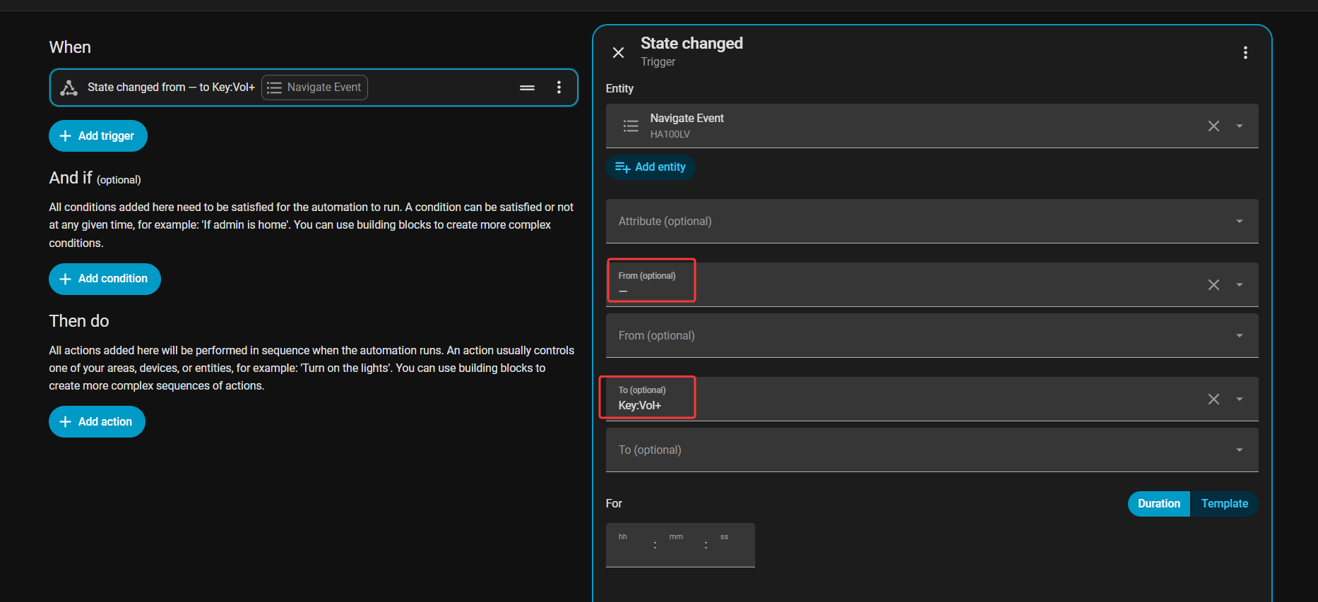

  3. Go to Automations. Under When, select our remote from the device list, choose the Event trigger, and configure it as follows:
    • From: select -
    • To: select the volume up or volume down button
  4. Finally, under Then do, add the corresponding script action you created in Step 2. The global button event configuration is now complete.
