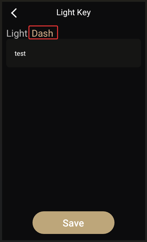

Hi there, regarding the first issue — this is not a bug. It’s working as designed.
In the initial implementation, we allowed the Lights button to bind to either a light device or a dashboard view, with light devices taking priority.
In the case you mentioned, the dashboard contained only scene cards and no actual light devices, so the system correctly offered only the dashboard view option.
However, once a light device is added to that dashboard, the system will prioritize the light device in the binding picker. The dashboard view option is still available — you just need to switch to it manually in the picker.
Please see the illustration below for details:
The Dash tab solved the binding problem, thanks.
