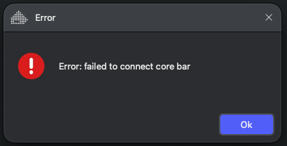

I can install the beta application. The application sees my Corebar, but cannot attach to it. I get an offline error.
Hi,David,
We have fixed the SSL issue in version 1.0.9 and have now released version 1.0.10.
Could you please help us test the new version when you have a chance? We would greatly appreciate it if you could verify that the SSL issue has been resolved and let us know if you encounter any other problems.
Thank you very much for your help, support, and valuable feedback. We truly appreciate your time and assistance.

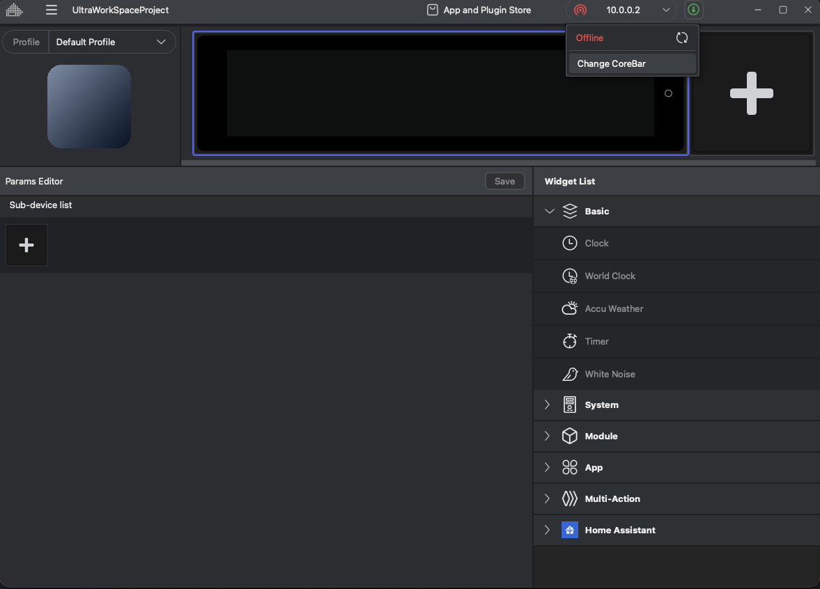

Hello, I have installed the version attached to this post and I am also receiving the same “offline” message in the app even though I was able to connect the bar itself to wifi. I am on a Mac mini M4 running IOS 27.
The IP address in the ultraworkspace app matches the IP address on the ultrabar when I go to the network settings. I have also double checked under the Mac privacy settings that the ultraworkspace app has permissions to connect to devices on the network. However, I still receive an “offline” error in ultraworkspace. If I attempt to deploy a project to the ultrabar I get an error for API timeout.
I’m not sure if it’s related, but in the ultrabar settings under “Auth” all I receive when entering that tile is “unauthorized” with nothing else on the screen.
pc-link also appears to not be working. Utilizing the front ports on the Mac mini registers the device as USB2 hub with a max speed of 480mb/s utilizing a thunderbolt 4 cable. The software does not connect to the Ultrabar via this link. Swapping to the rear ports on the Mac mini causes the device not to register at all. I have also tried non-thunderbolt cables.
same cable, same front port registers iPhone as USB3 Gen2 hub at 10gb/s. This result is duplicated with the rear port, USB3 10gb/s.
Follow-up — got 1.0.10 connected on Apple Silicon. Root cause of the “Offline” / “API timeout” errors (@davidturetsky, @joshputman)
Setup: MacBook Pro M4 Max, macOS 27.0.1, UltraWorkSpace V1.0.0-10, CoreBar on the same 2.4GHz Wi-Fi.
1.0.10 still fails on Apple Silicon. The app’s own log (launched from Terminal) shows three packaging problems:
1) Discovery: NSLocalNetworkUsageDescription is still missing in 1.0.10. As noted in post #2, macOS never prompts, the app never appears in Local Network, and UDP discovery on port 5319 is silently blocked. Adding the key and re-signing fixed discovery.
2) “Offline”: Qt uses the SecureTransport TLS backend. Log: ssl:Secure Transport, then SecureTransport does not support TLS 1.3 and [CoreBarConnectionTcp] Socket error: 20, Unable to init SSL Context. The CoreBar API on port 7431 is TLS 1.3 only, so the connection can never succeed. This is likely the “SSL issue” from 1.0.9, and it isn’t fixed on Apple Silicon.
3) The OpenSSL backend can’t load: the bundled libssl.3.dylib and libcrypto.3.dylib are x86_64 only. The app runs as arm64, so libqopensslbackend reports “Failed to load libssl/libcrypto” and Qt falls back to SecureTransport.
Fix I applied locally: removed PlugIns/tls/libqsecuretransportbackend.dylib, replaced the two OpenSSL dylibs with arm64 OpenSSL 3 builds (install names set to @rpath and @loader_path), and re-signed ad-hoc. Result: ssl:OpenSSL 3.6.4, connect succeed, request token succeed, CoreBar state 2 (online).
Suggested fixes for the release build:
  • Add NSLocalNetworkUsageDescription to Info.plist
  • Bundle universal (arm64 + x86_64) libssl/libcrypto, and/or call QSslSocket::setActiveBackend("openssl")
  • Remove the SecureTransport TLS plugin (deprecated, no TLS 1.3)
  • Sign with a Developer ID and notarize (currently ad-hoc, bundle ID com.yourcompany.UltraWorkSpace)
  • Minor: the device certificate’s CN is ultrabar.local, so connecting by IP logs a hostname-mismatch SSL error. It still connects.
Happy to share full logs.
